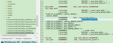

  About the function copy to RAM, when I define the code, I even didn't modify the ld file, I just define it like this:
_RAMFUNC(RAM4) void SysTick_DelayTicks(uint32_t n)
g_systickCounter = n;
while (g_systickCounter != 0U)
Then the map file you can find the SysTick_DelayTicks in RAM4.

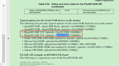

  Just confirm your function again, do you want to use the secondary bootloader which can operate the hyperflash when the bootloader code already running in the flash, right? If yes, as the RT1060 contains the ota_bootloader, that just meet your demand, but that project is using the QSPI, what you need to do is to modify option, then the ROM API will help you do it. do you mind to use this way instead of porting your project?
   SDK_2_10_0_EVK-MIMXRT1060\boards\evkmimxrt1060\bootloader_examples\ota_bootloader
 I think to try this method will save your time.
eg: bootloader_config.h
Modify from:
// The FLASH is a QSPI FLASH which supports JESD216 standard, working at 120MHz
#define BL_FLEXSPI_NOR_CFG_OPT0 (0xc0000006u)
#define BL_FLEXSPI_NOR_CFG_OPT1 (0x0u)
To hyperflash:
// The FLASH is a hyer 3V0, 100Mhz
#define BL_FLEXSPI_NOR_CFG_OPT0 (0xc0333006u)
Then you can try to test it directly.
