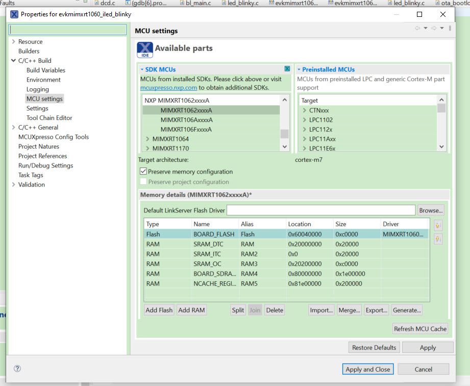

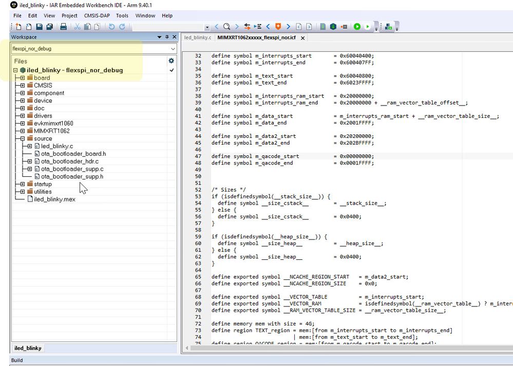

2.1.1 memory modification
   APP memory start address modify from 0x60000000 to 0x60040000, which is the ota_bootloader defined address。
Fig 1

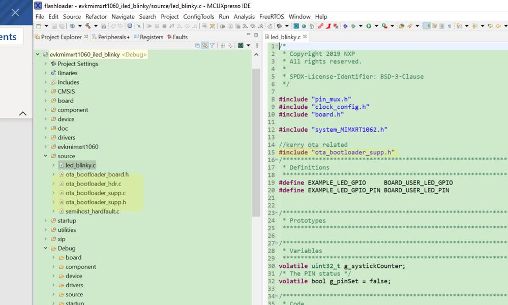

2.1.2 ota_hdr related files add
  In the led_blinky project source folder, add the mentioned ota_bootloader related files.
Fig 2

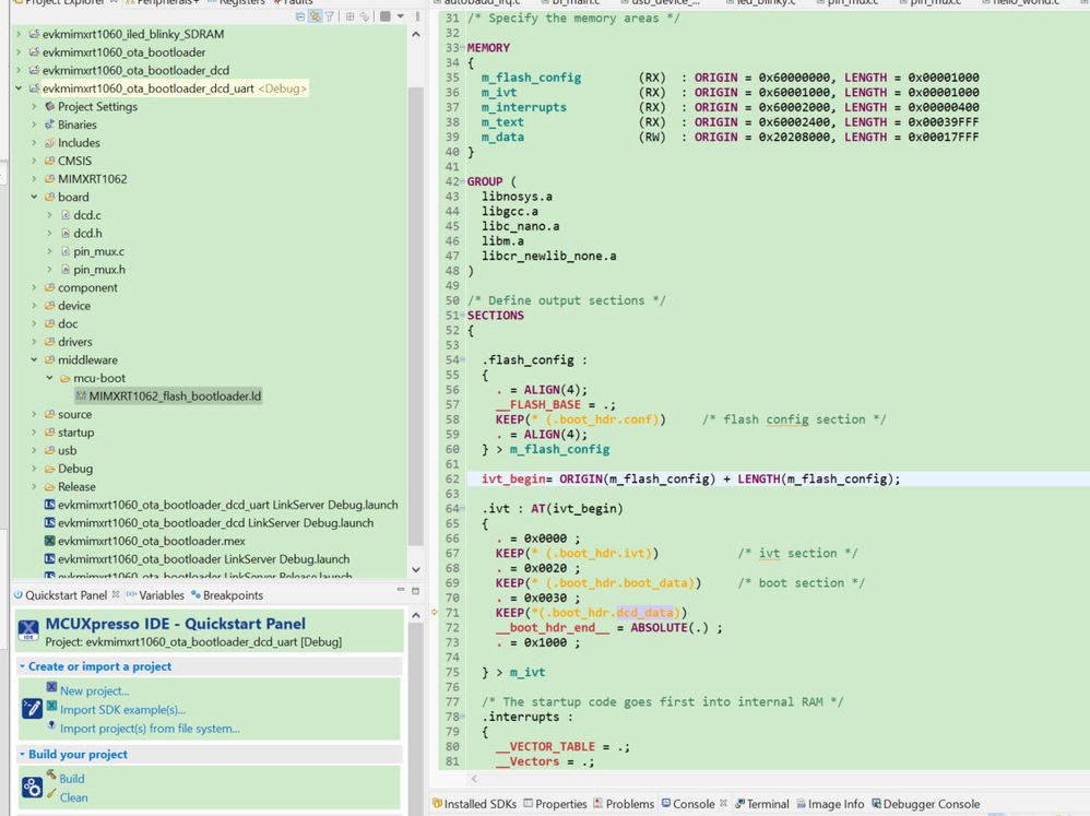

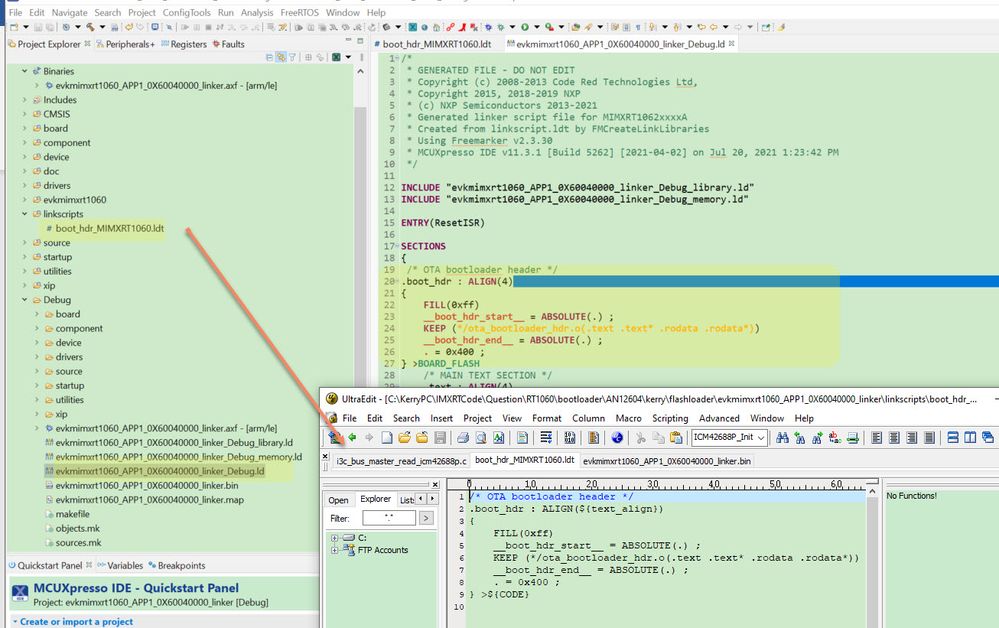

2.1.3 linker file modification
In the evkmimxrt1060_iled_blinky_debug.ld, add boot_hdr, length is 0X400.
We can use the MCUXpresso IDE linkscripts folder, add the .ldt files to modify the linker file.
Here, in the project, add one linkscripts folder, add the boot_hdr_MIMXRT1060.ldt file, build .
Fig 3

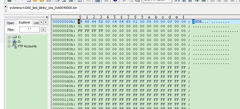

After the build, we can find the ld file already add the ota_header in the first 0x400 range.
Fig 4
The above is the generated evkmimxrt1060_iled_blinky_ota_0x60040000.bin file, we can find already contains the boot_hdr.
From offset 0x400, will put the real APP code.

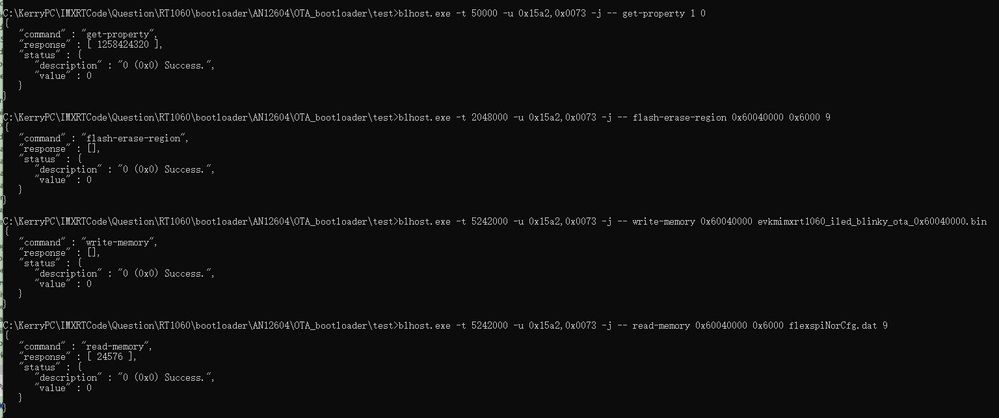

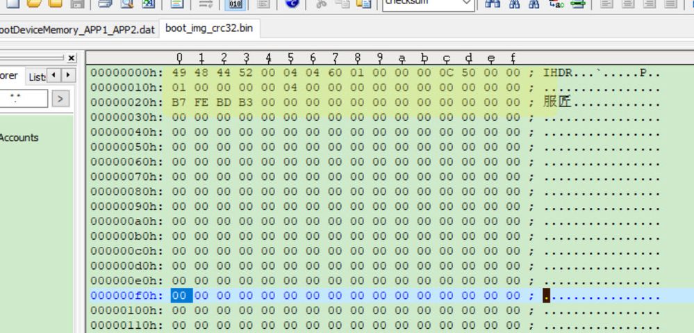

2.2 ISP test related command
Test board is MIMXRT1060-EVK, download the evkmimxrt1060_ota_bootloader project at first, can use the mcuxpresso IDE download it directly, then press the reset button, put the blhost and evkmimxrt1060_iled_blinky_ota_0x60040000.bin in the same folder, use the following command:
blhost.exe -t 50000 -u 0x15a2,0x0073 -j -- get-property 1 0
blhost.exe -t 2048000 -u 0x15a2,0x0073 -j -- flash-erase-region 0x60040000 0x6000 9
blhost.exe -t 5242000 -u 0x15a2,0x0073 -j -- write-memory 0x60040000 evkmimxrt1060_iled_blinky_ota_0x60040000.bin
blhost.exe -t 5242000 -u 0x15a2,0x0073 -j -- read-memory 0x60040000 0x6000 flexspiNorCfg.dat 9
Fig 5
After the download is finished, press the reset, wait 5 seconds, it will jump to the app, we can find the MIMXRT1060-EVK on board led is blinking. This method realize the flash ISP bootloader downloading and the app working.

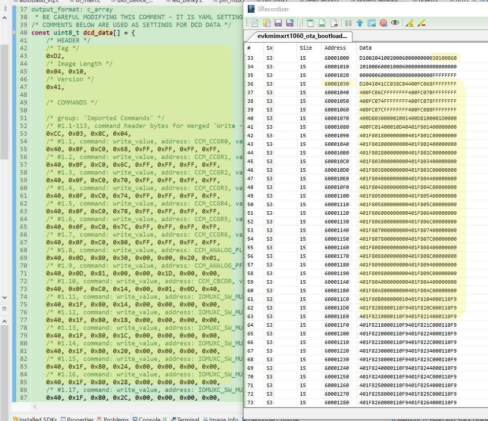

2.3.1 Ota_bootloader add dcd
2.3.1.1 add dcd files
  ota_bootloader add dcd.c dcd.h, these two files can be found from the SDK hello_world project. Copy these two files to the ota_bootloader board folder. From the dcd.c code, we can see, dcd_data[] array is put in the “.boot_hdr.dcd_data” area, and it need to define the preprocessor:
XIP_BOOT_HEADER_DCD_ENABLE=1
2.3.1.2 add dcd linker code
  Modify the mcuxpresso IDE ld files, and add the dcd range.
 .ivt : AT(ivt_begin)
	. = 0x0000 ;
	KEEP(* (.boot_hdr.ivt))           /* ivt section */
    . = 0x0020 ;
	KEEP(* (.boot_hdr.boot_data))     /* boot section */
    . = 0x0030 ;
    KEEP(*(.boot_hdr.dcd_data))
    __boot_hdr_end__ = ABSOLUTE(.) ;
    . = 0x1000 ;
  } > m_ivt
Fig 6
0x60001000 : IVT
0x6000100c : DCD entry point
0x60001020 : boot data
0x60001030 : DCD detail data

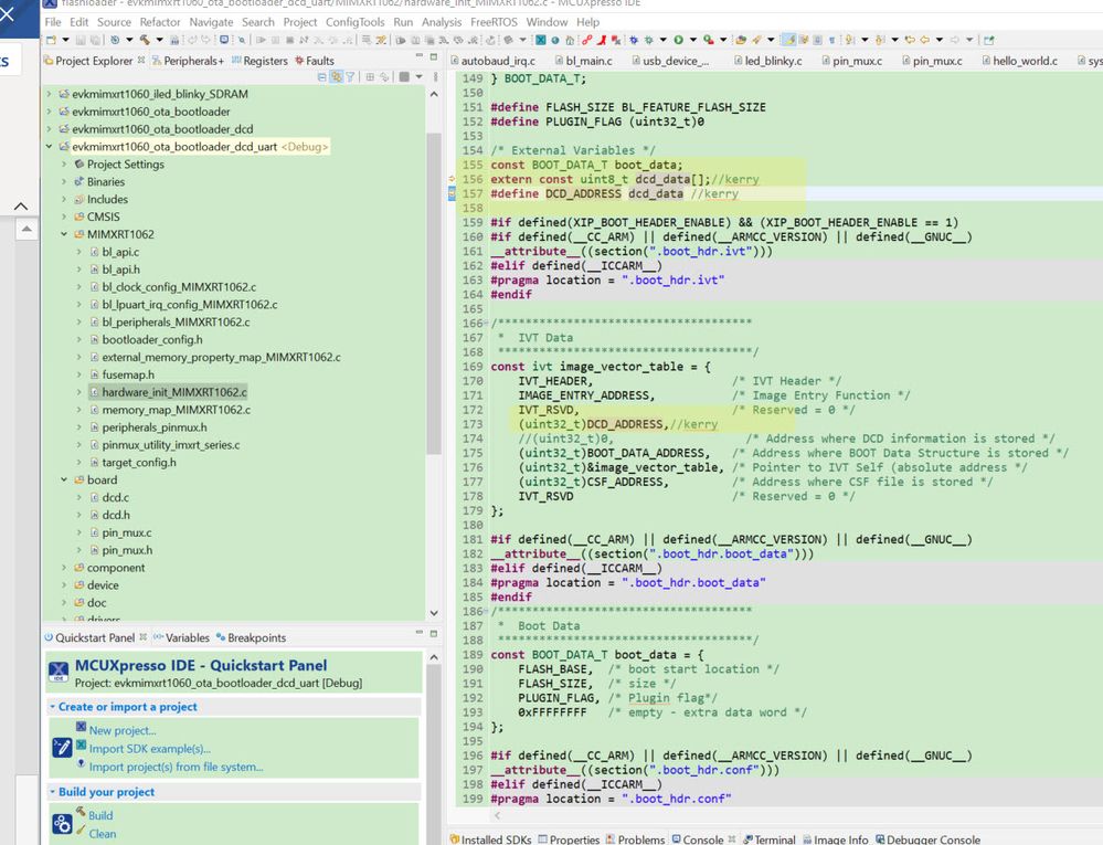

2.3.1.3 add IVT dcd entry point
  ota_bootloader->MIMXRT1062 folder->hardware_init_MIMXRT1062.c,modify the image_vector_table, fill the DCD address to the dcdc_data array address as the dcd entry point.
Fig 7
Until now, we finish the ota_bootloader dcd add, build the project, generate the image, we can find, DCD already be added to the ota_bootloader image.
Fig 8
DCD entry point in the IVT and the DCD data is correct, we can burn this modified ota_bootloader to the MIMXRT1060-EVK board.

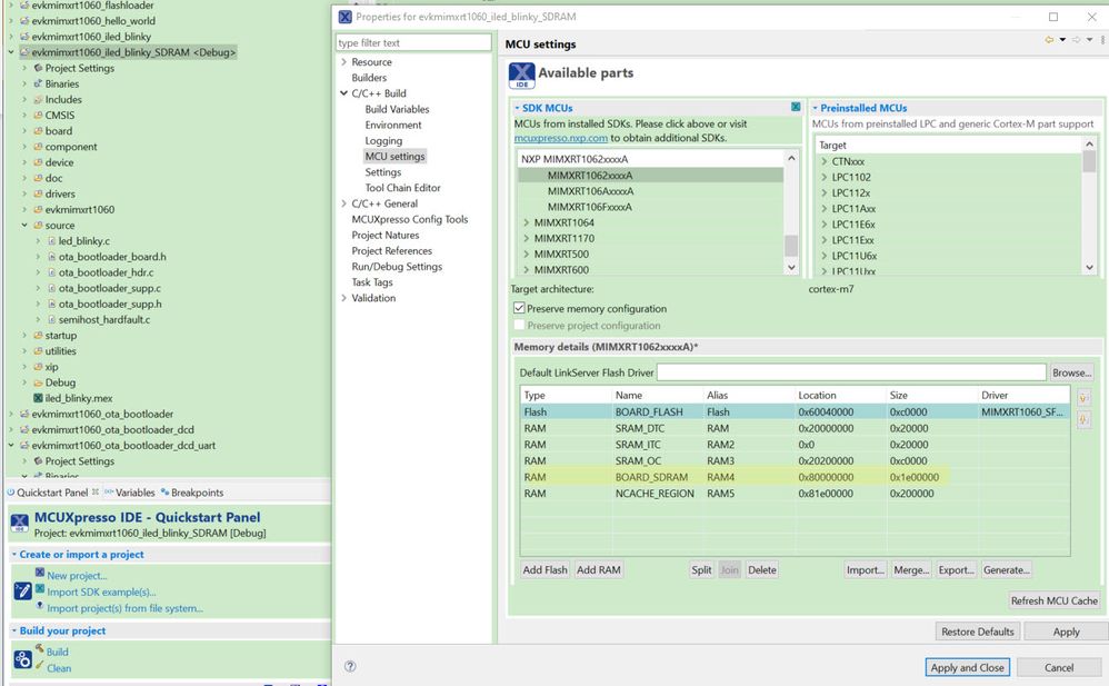

2.3.2 SDRAM app prepare
Still based on the evkmimxrt1060_iled_blinky project, just put some function in the SDRAM. From memory, we can find, the SRAM is in the RAM4:
Fig 9
In the led_blinky.c, add this header:
#include <cr_section_macros.h>
Then, put the systick delay code to the RAM4 which is the SDRAM area.
__RAMFUNC(RAM4) void SysTick_DelayTicks(uint32_t n)
    g_systickCounter = n;
    while (g_systickCounter != 0U)
Now, we already finish the simple SDRAM app, we also can test it, and put the breakpoint in the SysTick_DelayTicks, we can find the address is also the SDRAM related address, generate the evkmimxrt1060_iled_blinky1_SDRAM_0x60040000.bin.
If use the old ota_bootloader to download this .bin, we can find the led is not blinking.

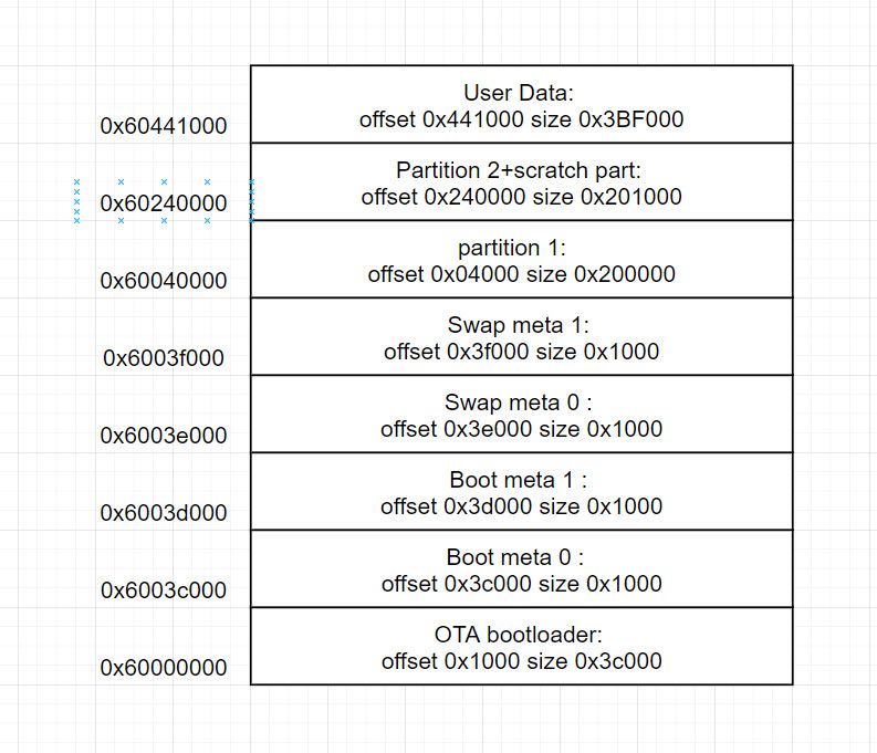

3.1  memory map
ota bootloader memory information.
Fig 10
The above map is based on the external 8Mbyte QSPI flash.
OTA bootloader: RT SDK ota bootloader code
Boot meta 0: contains 3 partition start address, size etc. information, ISP peripheral information.
Boot meta 1: contains 3 partition start address, size etc. information, ISP peripheral information.
Swap meta 0: bootloader will use meta data to do the swap operation
Swap meta 1: bootloader will use meta data to do the swap operation
Partition 1: APP1 location
Partition 2: APP2 location
Scratch part: APP1 backup location, start point is before 0x60441000, which is enough to put APP1 and multiple sector size, eg, APP1 is 0X5410, sector size is 0x1000, APP1 need 6 sectors, so the scratch start address is 0x60441000-0x6000=0x43b000.

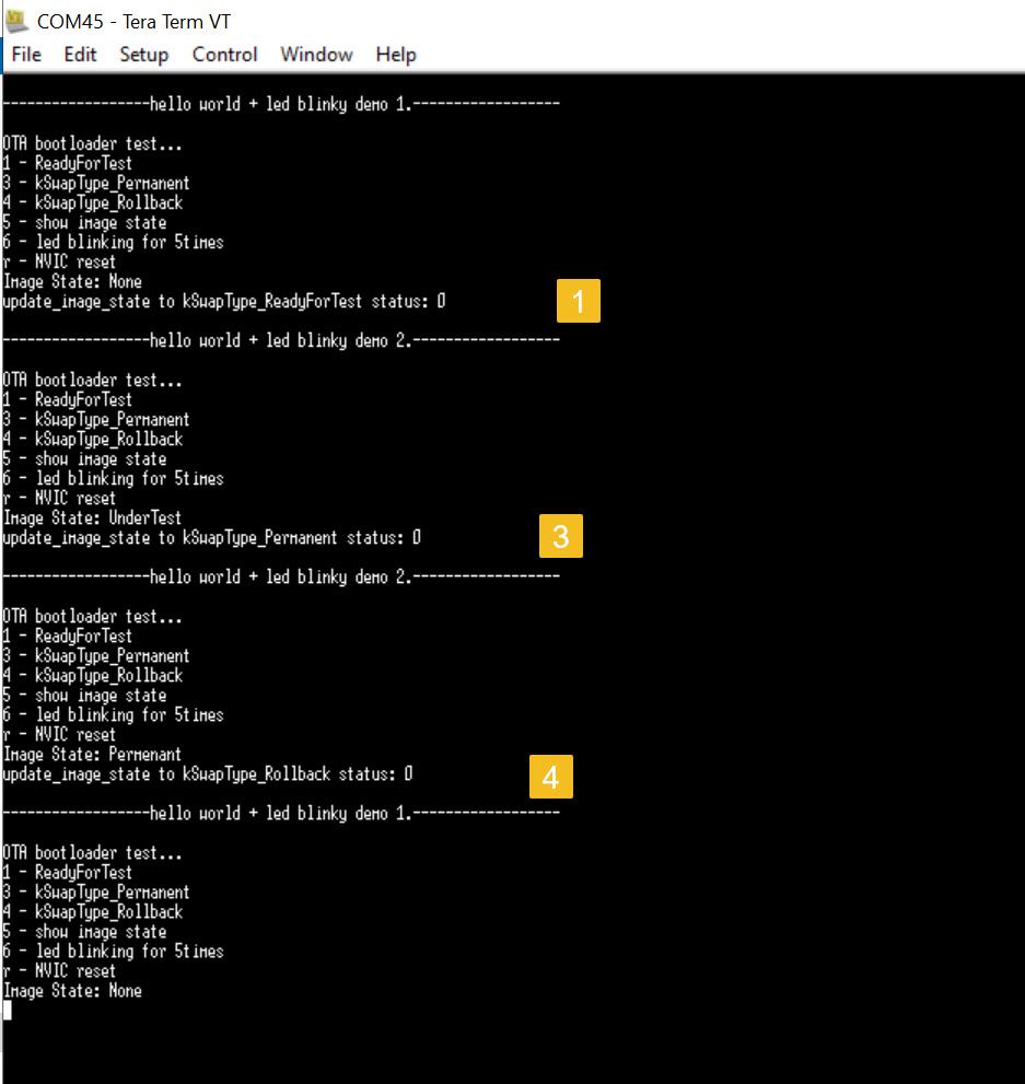

3.4  Swap rollback APP prepare
Prepare two APPs: APP1 and APP2 bin file, and use the USB HID download to the partition1 and paritition 2. After reset, run APP1 in default, then use the COM input to select the swap and rollback function.
Code is:
int main(void)
    char ch;
    status_t status;
    /* Board pin init */
    BOARD_InitPins();
    BOARD_InitBootClocks();
    /* Update the core clock */
    SystemCoreClockUpdate();
    BOARD_InitDebugConsole();
    PRINTF("\r\n------------------hello world + led blinky demo 2.------------------\r\n");
    PRINTF("\r\nOTA bootloader test...\r\n"
        "1 - ReadyForTest\r\n"
        "3 - kSwapType_Permanent\r\n"
        "4 - kSwapType_Rollback\r\n"
        "5 - show image state\r\n"
    	"6 - led blinking for 5times\r\n"
        "r - NVIC reset\r\n");
    // show swap state in swap meta
    get_image_swap_state();
    /* Set systick reload value to generate 1ms interrupt */

When download the APP, need to use the correct ota_header in the first 0x400 area, otherwise, swap will failed.
const boot_image_header_t ota_header = {
    .tag           = IMG_HDR_TAG,
    .load_addr     = ((uint32_t)&ota_header) + BL_IMG_HEADER_SIZE,
    .image_type    = IMG_TYPE_XIP,
    .image_size    = 0,
    .algorithm     = IMG_CHK_ALG_CRC32,
    .header_size   = BL_IMG_HEADER_SIZE,
    .image_version = 0,
    .checksum      = {0xFFFFFFFF},
This is a correct sample:
Fig 12
Image size and checksum need to use the real APP image information, in the attached file, provide one image_header_padding.exe, it can input the none ota header image, then it will output the whole image which add the ota_header contains the image size and the image crc data in the first 0x400 range.

This is the test result:
Fig 13
From the test result, we can find, in the first time boot, APP1 running, image state: none
Input 1, do the swap, will find the APP2 running, image state: undertest
Input 3, select permanent, reset will find, still APP2 running, image state: permanent
Input 4, choose rollback, reset will find APP1 running, image states: none
Until now, finish the swap and rollback function.
Input 6, will find the APP contains the SDRAM led blinky is working.

Some customer also need the IAR version, so here attach the iar app version.
Based on the led_blinky iar project, the modification is:
1. Copy the ota_bootlaoder_board.h, ota_bootloader_hrd.c, ota_bootloader_supp.c, ota_bootloader_supp.h to the source folder
2. delete the XIP folder
3. led_blinky.c add:
#include "ota_bootloader_supp.h"
4. the MIMXRT1062xxxxx_flexspi_nor.icf modified like this:
**     Processors:          MIMXRT1062CVJ5A
**                          MIMXRT1062CVL5A
**                          MIMXRT1062DVJ6A
**                          MIMXRT1062DVL6A
**     Compiler:            IAR ANSI C/C++ Compiler for ARM
**     Reference manual:    IMXRT1060RM Rev.1, 12/2018 | IMXRT1060SRM Rev.3
**     Version:             rev. 0.1, 2017-01-10
**     Build:               b210227
**     Abstract:
**         Linker file for the IAR ANSI C/C++ Compiler for ARM
**     Copyright 2016 Freescale Semiconductor, Inc.
**     Copyright 2016-2021 NXP
**     All rights reserved.
**     SPDX-License-Identifier: BSD-3-Clause
**     http:                 www.nxp.com
**     mail:                 [email protected]
define symbol m_ota_boot_hdr_start     = 0x60040000;
define symbol __ram_vector_table_size__        =  isdefinedsymbol(__ram_vector_table__) ? 0x00000400 : 0;
define symbol __ram_vector_table_offset__      =  isdefinedsymbol(__ram_vector_table__) ? 0x000003FF : 0;
define symbol m_interrupts_start       = 0x60040400;
define symbol m_interrupts_end         = 0x600407FF;
define symbol m_text_start             = 0x60040800;
define symbol m_text_end               = 0x6023FFFF;
define symbol m_interrupts_ram_start   = 0x20000000;
define symbol m_interrupts_ram_end     = 0x20000000 + __ram_vector_table_offset__;
define symbol m_data_start             = m_interrupts_ram_start + __ram_vector_table_size__;
define symbol m_data_end               = 0x2001FFFF;
define symbol m_data2_start            = 0x20200000;
define symbol m_data2_end              = 0x202BFFFF;
define symbol m_qacode_start           = 0x00000000;
define symbol m_qacode_end             = 0x0001FFFF;
/* Sizes */
if (isdefinedsymbol(__stack_size__)) {
  define symbol __size_cstack__        = __stack_size__;
} else {
  define symbol __size_cstack__        = 0x0400;
if (isdefinedsymbol(__heap_size__)) {
  define symbol __size_heap__          = __heap_size__;
} else {
  define symbol __size_heap__          = 0x0400;
define exported symbol __NCACHE_REGION_START   = m_data2_start;
define exported symbol __NCACHE_REGION_SIZE    = 0x0;
define exported symbol __VECTOR_TABLE          = m_interrupts_start;
define exported symbol __VECTOR_RAM            = isdefinedsymbol(__ram_vector_table__) ? m_interrupts_ram_start : m_interrupts_start;
define exported symbol __RAM_VECTOR_TABLE_SIZE = __ram_vector_table_size__;
define memory mem with size = 4G;
define region TEXT_region = mem:[from m_interrupts_start to m_interrupts_end]
                          | mem:[from m_text_start to m_text_end];
define region QACODE_region = mem:[from m_qacode_start to m_qacode_end];
define region DATA_region = mem:[from m_data_start to m_data_end-__size_cstack__];
define region DATA2_region = mem:[from m_data2_start to m_data2_end];
define region CSTACK_region = mem:[from m_data_end-__size_cstack__+1 to m_data_end];
define block CSTACK    with alignment = 8, size = __size_cstack__   { };
define block HEAP      with alignment = 8, size = __size_heap__     { };
define block RW        { readwrite };
define block ZI        { zi };
define block NCACHE_VAR    { section NonCacheable , section NonCacheable.init };
define block QACCESS_CODE  { section CodeQuickAccess };
initialize by copy { readwrite, section .textrw, section CodeQuickAccess };
do not initialize  { section .noinit };
place at address mem: m_interrupts_start    { readonly section .intvec };
place at address mem:m_ota_boot_hdr_start { object ota_bootloader_hdr.o };
keep { object ota_bootloader_hdr.o };
place in TEXT_region                        { readonly };
place in DATA_region                        { block RW };
place in DATA_region                        { block ZI };
place in DATA_region                        { last block HEAP };
place in DATA_region                        { block NCACHE_VAR };
place in CSTACK_region                      { block CSTACK };
place in QACODE_region                      { section .textrw};
place in QACODE_region                      { block QACCESS_CODE };
Then build the project, to get the evkmixrt1060_iled_blinky_ota_0x60040000_iar.bin
After download the ota_bootloader, use the blhost to connect it after board reset:
C:\KerryPC\IMXRTCode\Question\RT1060\bootloader\AN12604\kerry\OTAtest>blhost.exe -t 50000 -u 0x15a2,0x0073 -j -- get-property 1 0
   "command" : "get-property",
   "response" : [ 1258424320 ],
   "status" : {
      "description" : "0 (0x0) Success.",
      "value" : 0
C:\KerryPC\IMXRTCode\Question\RT1060\bootloader\AN12604\kerry\OTAtest>blhost.exe -t 2048000 -u 0x15a2,0x0073 -j -- flash-erase-region 0x60040000 0x6000 9
   "command" : "flash-erase-region",
   "response" : [],
   "status" : {
      "value" : 0
C:\KerryPC\IMXRTCode\Question\RT1060\bootloader\AN12604\kerry\OTAtest>blhost.exe -t 5242000 -u 0x15a2,0x0073 -j -- write-memory 0x60040000 evkmixrt1060_iled_blinky_ota_0x60040000_iar.bin
   "command" : "write-memory",
   "response" : [],
   "status" : {
      "value" : 0
Find the iar app in the original post.
