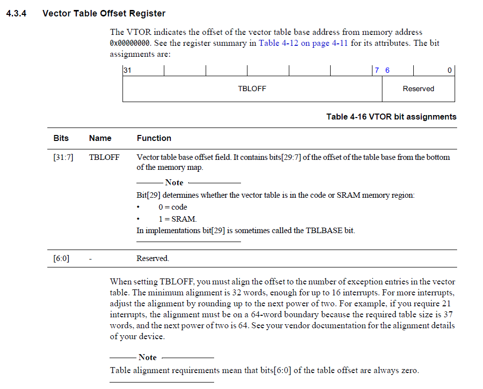

We're using the RT1021 MCU and our application needs to keep a timer interrupt running even while programming the flash chip.  I moved my interrupt handlers into RAM and even the drivers just to try and avoid bus errors.  I'm getting exceptions when I get PIT timer interrupts anyway.    Why would these be occurring with interrupt handlers in RAM?  The handlers don't execute code in the flash chip.  Does it make sense that I would have to disable ALL interrupts in order to erase or program the flexspi nor chip?  Is there some lower level code being linked in for interrupts?  Could it come down to the NVIC not being in RAM?

[email protected]‌ sorry about the wrong info. 128 byte alignment is the minimum for an M4 processor. However actual alignment depends on the number of vectors your table has. You need to round to the next power of 2.
For example, if your table has 68 vectors it needs 68x4 bytes so it needs 272 bytes. so the next power of2 would be 2^9 or 512 bytes, since 2^8 is 256 and you need more than that.

You don't need to place everything on RAM.
Look at the ResetISR, usually it will set the VTOR to point to the Vector Table in Flash.
You can change the code so it will copy the vector table to RAM and then point the VTOR to that location.
You'll also need to make sure the location is **Correction** 128 byte aligned and that the linker will not try to use that RAM location.
You can do that by excluding that area from the RAM settings or by placing a NOINIT array where the vector table will be.

Thanks for the updated information!  I sectioned off 0x300 bytes off the bottom of ITC RAM and used that, then moved it to be after the larger ITC RAM segment in the list so my interrupt handlers would be automatically loaded into the larger segment.  Starting at zero surely is 512 byte aligned.  It seems to work great now!  Thank you so much for your help!

Are you sure that the interrupt vector table itself is in RAM?

NVIC is internal to the Cortex-M7 core but the interrupt vectors (pointed to by VTOR) can be anywhere - best in ITC since they are fastest there. If they are in SPI flash it will be your issue.
