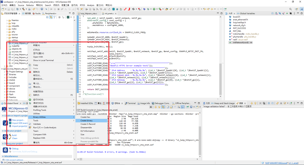

Step4. Release build the "v1_lwip_httpssrv_ota_enet" and "v2_lwip_httpssrv_ota_enet" project
Step 5. Create the binary file of "v1_lwip_httpssrv_ota_enet" and "v2_lwip_httpssrv_ota_enet"

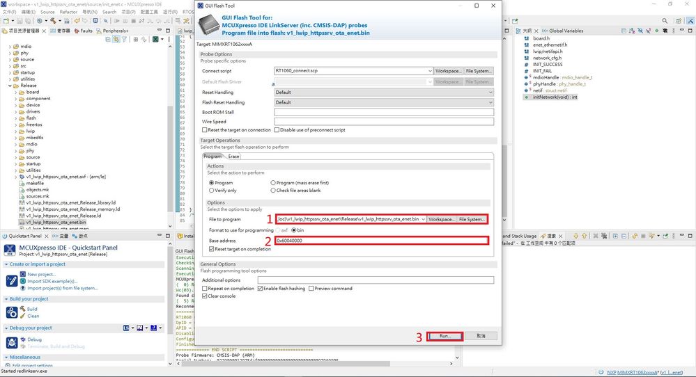

Step 7. Use the GUI flash tool to flash the binary file to RT1060 EVK board.
evkmimxrt1060_ota_bootloader.bin(0x60000000)
v1_lwip_httpssrv_ota_enet.bin(0x60040000)

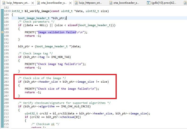

After upgraded successful at step 9, I found that application check size of the image failed while running "bl_verify_image((void *)update_partition.start, stored" function at step10.
May I ask what's the difference after I first time upgraded the image?
