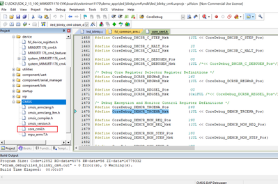

Charindu_Abeysekara
it occurs 5 errors occurs undeclared identifier.
10,350 Views
Harry_Zhang
Hi @Charindu_Abeysekara
According to the error message, you may be lack of core_cm4.h. Please check it.
Or you can reinstall the chip pack.
Hope this will help you.
Hang
