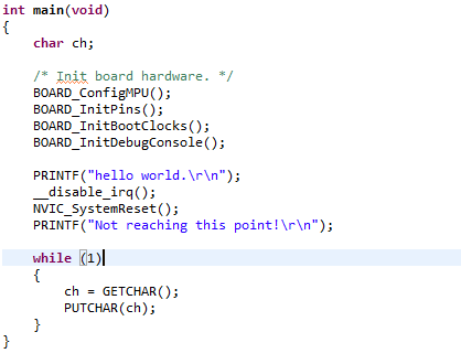

I am using MiMxRT1020 development kit.. I want to update firmware via TCP with bootloader. As soon as I receive my new firmware I want to reset application and I want to jump to the bootloader mode. But NVIC_SystemReset() is not working. So I can not update my firmware. Here is sample of my code.
if(ack_offset == 0xffff) {
/* received complete firmware */
osDelay(2000);
__disable_irq();
/* reset application */
NVIC_SystemReset();

@Sabina_Bruce that is not a proper test!
If you look at the NVIC_Reset inline function, you will see that the attempt at reset is followed by an infinite loop:
for(;;) {}
So you have not proved the reset works. You need to test an application that has actual reset capability and without debug pod attached.

Sabina_Bruce
Hello ,
Hope you are doing well.
I have tested this one my end without any issue.
I used the simple hello world example. Placed the NVIC_SystemReset after it prints hello world.
It will not reach the next printf as it resets the application.
I am using the latest IDE and SDK version.
Sabina
