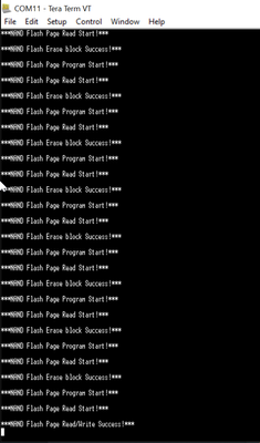

   The board :
Populate R1872~R1879 to use NANDFlash
  is solder by my another colleague, today, I remove it, and solder it again, then it works OK, no matter SDK2.13.0, SDK2.14.0, SDK2.15.0, all works ok.
This is the test result:
Sorry for the confusing, please solder your hardware and test it again.
If you still have issues about it, please kindly let me know.
Kerry

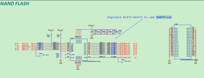

  You want to run the MIMXRT1170-EVKB on board nandflash, right?
If yes, please :
1. hardware:
To make the examples works, please add resistors:
R1872,R1873,R1874,R1875,R1876,R1877,R1878,R1879
2. software
You can use the SDK demo:
SDK_2_14_0_MIMXRT1170-EVKB\boards\evkbmimxrt1170\component_examples\flash_component\semc_nand\cm7
This code will erase, program and read the data to the nandflash.
Wish it helps you!
Kerry

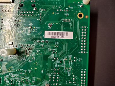

VojtechBaranek
Hi @kerryzhou
I double checked under microscope and all those 8 connecting resistors seem to be soldered OK. If no extra modifications (like moving some jumpers) must be done, it should work.
So if you have a possibility to test the demo on your side, I will be grateful, as it will help me know where to focus. To tell you my version of the board, I enclose these photos, which I hope contain that info.
Thank you.
Best regards Vojtech
