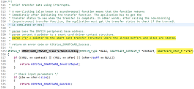

Hi There,
I am trying to test the SMARTCARD Module (EMVSIM) on an i.MX-1170 EVK. Using the example provided in the SDK for cm7. I noticed that the threshold is by default 16 for TX and 15 for RX. Thus, when sending large command size to the SC it fails. How can I change it to withstand large data sizes. Also, I noticed that the in order to send a command to the SC. I must separate the sent buffer into command and body. Can't I send the entire command as one chunk.
Thanks in advance.
510 Views
EdwinHz
Hi @k_alahmadi01,
You can change the amount of sent/received bytes by changing the "*buff" and "size" values of the "smartcard_xfer_t" structure that is used for each "SMARTCARD_EMVSIM_TransferNonBlocking()" function call:
