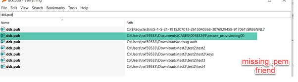

I am concerned about the debug Credential Key you have DCK.pub , I have not find its associated .pem in your files. Or as it is private, did you put it somewhere else? Or did you verified that the .pub you gave us , corresponds to the .pem you have?
So what I suggest you to do is:
 generate debugger key pair ( I have not seen this command yet on your files or description)
nxpkeygen -d debug -k rsa2048 keys\dck.pem
So, when calling the this command give the dck.pem
nxpdebugmbox -vv auth -b 0 -c auth.dc -k dck.pem

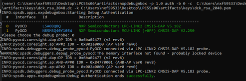

Here is an example with the LPC55
Here is another tip:  I recommend you to load J-Link into your  LPC-LINK2. Sometimes when we enable debug authentication, Segger is more reliable to initiate a debug session on the MCUXpresso. I do not why , but I have seen this on the LPC55.
