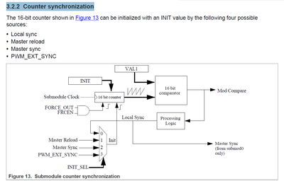

My new related question is about a function I need to implement, but I can't figure out how to do it cleanly and possibly totally in hardware.
I have a periodic square signal generated by my application.
I need to generate a new periodic square signal that is 8 time more fast and that perfectly sync with the signal above, every it's rise edge.
In the Reference Manual I saw this block diagram:

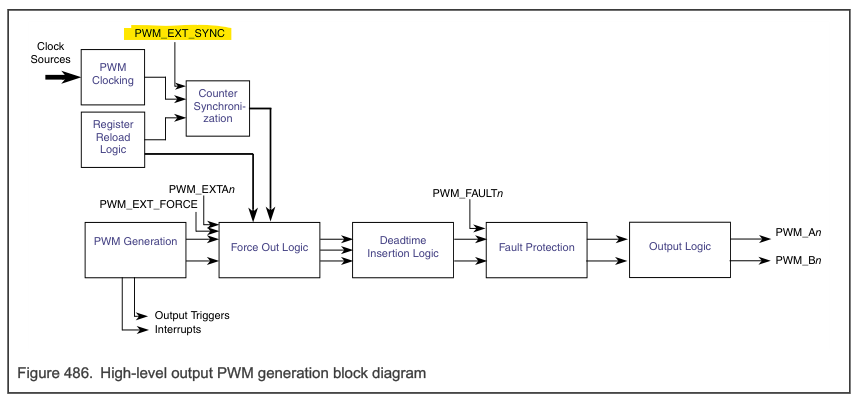

However, going into more detail about the behavior of PWM_EXT_SYNC I found this block diagram:
It seems that the PWM peripheral is unable to simultaneously generate the PWM signal and synchronize with the external signal, is this true?
Can you help me to find a good solution for my needs?

Hi @silvio-vallorani ,
Thanks for your updated information.
Q: It seems that the PWM peripheral is unable to simultaneously generate the PWM signal and synchronize with the external signal, is this true?
A: The FlexPWM module on i.MX RT1180 can simultaneously generate PWM outputs and synchronize its counter to an external signal.
For more detailed information, I suggest you can refer to this Application Note : AN14196: Flex Pulse Width Modulator (FlexPWM) Usage on MCX N Series | NXP Semiconductors,
especially Section 3.2.2 “Counter Synchronization”, which describes how the FlexPWM counter can be synchronized across modules or via external sources.
