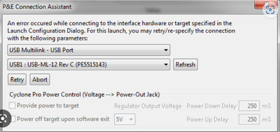

My Question:
Is there a specific requirement for debugging MIMXRT1064DVL6A MCU in specifically designed card?
We designed a micro computer by using MIMXRT1064DVL6A for our startup in university research lab. I am using 10-pin JTAG Connector same as J34 in EVK. The JTAG_TMS, JTAG_TCK, JTAG_TDI, JTAG_TDO, and JTAG_nTRST pins connected corresponding counterparts for JTAG PORT in MCU PINOUT Page in SPF-32221_A2.pdf.
I am not able to debug my card. MCUXpresso returns PEMicro Connection Assistant window. It says “An error occurred while connecting to the interface hardware or target specified in the Launch Configuration Dialog….”
Could you please help me about what kind of tricks should be considered in this scenario?

I think by default MIMXRT1064 is in SWD mode. For JTAG mode you need to reconfigure it.

Hello, The recommendation is in the HDG and this thread.
https://www.nxp.com/webapp/Download?colCode=MIMXRT105060HDUG
Design Considerations for Debug - NXP Community
The windows that you mentioned are similar to the image below. If yes, the common cases are, because the connection is too long, does not have power [the universal multilink FX is the only one that can provide power], and the cable connection is the other way around.
Confirm that and tell me if the problem persists.

I have the same window with little difference, my second combobox holds “UMultilink Universal FX Rev B on USB1(Name=PEM)” instead “USB1: USB-ML-12 Rev C (PE5515143)”. I tried and checked the issue which you link. Unfortunately problem is still around.
I am continue for trials.
Do you know another board specific prerequisites which I should apply to my card?
