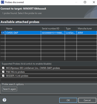

Hi team,
I have a problem with debug as below description.
Please guide us to fix it.
Executing flash operation 'Program'
Checking MCU info...
Scanning for targets...
Executing flash action...
MCUXpresso IDE RedlinkMulti Driver v11.3
( 0) Reading remote configuration
Wc(03). No cache support.
Found chip XML file in
( 5) Remote configuration complete
Reconnected to existing LinkServer process.
============= SCRIPT: RT1064_connect.scp =============
RT1064 Connect Script
DpID = 0BD11477
Error: Wire Ack Wait Fault
Disabling MPU
Configure FlexRAM for 768KB OC RAM, 128KB I-TCM, 128KB D-TCM
Finished
============= END SCRIPT =============================
Probe Firmware: CMSIS-DAP (ARM)
Serial Number: 023200001
VID:PID: 0D28:0204
USB Path: \\?\hid#vid_0d28&pid_0204&mi_03#8&26260f74&0&0000#{4d1e55b2-f16f-11cf-88cb-001111000030}
connection failed - Em(01). Cannot find MEM-AP selected by core index (check target power).. Retrying
Failed on connect: Em(01). Cannot find MEM-AP selected by core index (check target power)
Connected&Reset. Was: NotConnected. DpID: 0BD11477. CpuID: 00000000. Info: <None>
Last stub error 0: OK
Last sticky error: 0x0 AIndex: 0
No debug bus (MemAp) selected
DAP Speed test unexecuted or failed
Debug protocol: SWD. RTCK: Disabled. Vector catch: Disabled.
(100) Target Connection Failed
Unable to perform operation!
Command failed with exit code 1

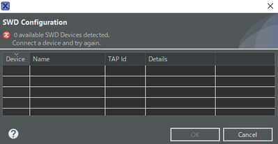

The same problem, but not on mimxrt1064.
In this case, may I use this method to fix?
If it's OK, Could you tell me the position of that jumper on mimxrt1064 by image
@Alice_Yang @Alexis_A
https://community.nxp.com/t5/LPC-Microcontrollers/LPC55S69-evk-quot-0-available-SWD-Devices-detected...
