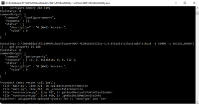

Hi, hope you are doing well, I have found a problem trying to use MCUBootUtility, I get the following error from cmd window on Win 10:
The Port setup led turns green, not blue, and shows the message "configure boot dvice".
I don't now much but seems to be a Python error, am I right?
I have installed the python 2.7 package like the installation step by step asks.
Could be possible that the installation files are corrupted?
Many thanks and best regards.

nicolasmuratore
Hi Victor, thanks for your support, next are the data that you asked:
MCUBootUtility 1.4.0
MIMXRT1020EVK
I have followed the next steps:
1) Connect the EVK to a PC (I have tested both possibilities USB-HID and UART).
2) Select the MCU (IMXRT1020) and "Boot device" as "SD Card" on "Target setup" section.
3) Press "Boot Device configuration" to check the SD card info.
4) Check the "Port status", select the correct port and then press "Connect to ROM" and wait until the led turns blue.
The last step fail, the led turn green and the cmd window show the message that I have posted.
I have tried using sdphost and blhost tools directly, and those seems to work, I mean I can download an image to an SD card.
So, I think maybe this issue have something to do with python version (2.7).
6,811 Views
victorjimenez
Hello Nicolas,
Did you put your board in serial downloader mode? This step is necessary, otherwise, it won't be possible for the tool to connect to the ROM bootloader.
Victor

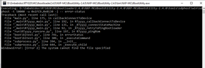

nicolasmuratore
Good day, trying with the MCUBootUtility version 2.4.0 and python 3.9.0,  I get the following error:
I don't understand what file it mention, everithing seems to be there.
I will try on another PC, maybe is a problem related to my computer.
Thanks.
6,735 Views
victorjimenez
This problem is not related to Windows 10, the PC that I'm using to make the tests on my side is running Windows 10.
Are you downloading all the files in the repository? From the link that I sent before, you need to download all the files in the repository. To do this you need to click on the following option.
Once you download the zip file you need to uncompress it. It seems that the problem that you are facing is due to missing files, probably you didn't download all the needed files.
Victor

nicolasmuratore
Hi Victor,  it's working now!!!
I've discovered that my antivirus send some files to quarantinee without warning me, disabling the antivirus and executing with administrator permissions the app works fine.
Many thanks.
