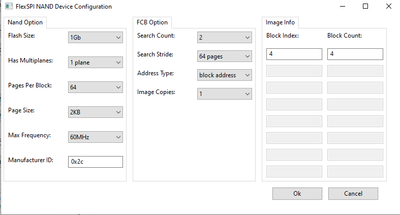

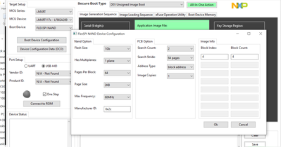

I am trying to config this QSPI Memory (Flexspi NAND) in MCUBootutility.
Memory:https://www.digikey.ca/en/products/detail/micron-technology-inc/mt29f1g01abbfdwb-it-f/7707445
I tried different configuration but not sure what I have wrong.
I attached the log below.
Thank you,

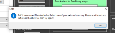

Executing: C:\Users\TarMha\Desktop\NXP-MCUBootUtility\tools\blhost2_3\win\blhost -t 50000 -u 0x15A2,0x0073 -j -- configure-memory 257 538976256
toolStatus: 0
commandOutput: {
"command" : "configure-memory",
"response" : [],
"status" : {
"description" : "4 (0x4) kStatus_InvalidArgument",
"value" : 4
Executing: C:\Users\TarMha\Desktop\NXP-MCUBootUtility\tools\blhost2_3\win\blhost -t 50000 -u 0x1FC9,0x013D -j -- get-property 1 0

commandOutput: {
"response" : [],
"status" : {
"value" : 4

TM_MI
Hello @jay_heng
Thank you for your reply.
I am using the latest version now but same error.
TM_MI_1-1681910714791.pngTM_MI_1-1681910714791.pngTM_MI_2-1681910757231.pngTM_MI_2-1681910757231.png

toolStatus: 0
commandOutput: {
"response" : [],
"status" : {
"value" : 4

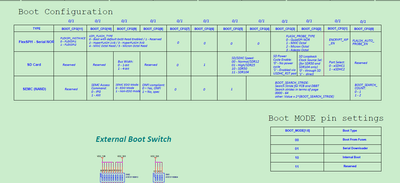

kerryzhou
Hi @TM_MI ,
    Google Coral Dev Micro board is not from NXP side, when you buy this board, whether they provide some document to get start it or not?
   I checked your schematic, the boot_cfg pin should follow this picture:
I think you need to check your board company, make sure it works at first, then enter the serial download mode, and connect it with MCUBootutility.
The above configuration should match your used nandflash.
Kerry
