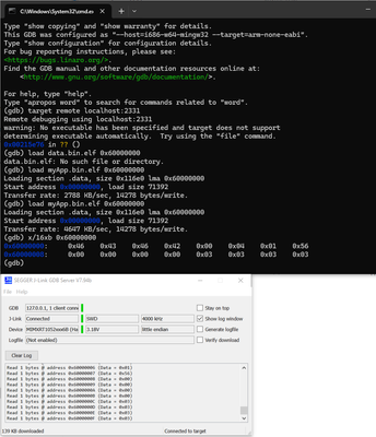

Following the reference link you gave, I tested it locally. https://mcuoneclipse.com/2022/11/01/loading-multiple-binary-files-with-gdb/
It is possible to load the MCUBoot project using GDB. The operation is consistent with the documentation. Here are my test results for reference:
Gavin_Jia_0-1720000590687.pngGavin_Jia_0-1720000590687.pngGavin_Jia_1-1720000636040.pngGavin_Jia_1-1720000636040.png

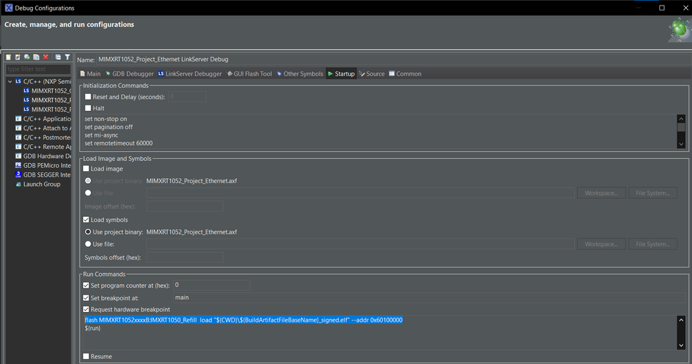

I use an MCU-link as a debugger interface. To manually load the signed application, I use a command like this:
LinkServer.exe flash MIMXRT1052xxxxB:IMXRT1050_Refill load C:\application_signed.bin --addr 0x60100000
I need to specify the flash command because I need to load this application onto a custom board that uses a different flash memory than the EVK board.
It work, the problem is that I don't know how to run this code automatically in the IDE. I tried a solution like this:
But it doesn't work; it seems that the command is completely ignored. I don't know how to check if the command reports an error when it is executed.
I tried various combinations of the command: I placed it in the initialization command section, in the run command section, and I tried the GDB version (like load data.bin.elf 0x70000). I attempted it with and without flash in front of it or on the previous line. Nothing changed; the load is never performed.

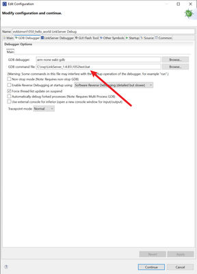

I tried your procedure with similar results. Also, I tried adding scripts, and if there are errors in the commands in the scripts, the IDE points them out when running Debug and the operation is interrupted:
So I think the commands in the script were actually executed successfully, except that in a subsequent operation, the IDE emptied the previous signed.bin file again. If you're just trying to burn it into flash and the command line succeeds, I don't think we actually need to stick to the IDE point-and-click-and-succeed approach.
It's perfectly fine to try writing scripts or executing it via the post-build command after compiling, after all, this operation doesn't require the IDE's debugging capabilities.
