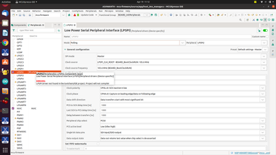

im trying to send data over LPSPI2 using EDMA in the peripheral tool configuration in the configuration setup its showing no LPSPI driver found  how to add sriver to this one im working on IMXRT1060s  LPSPI2 as slave  im using ths API for sending data LPSPI_SlaveTransferEDMA(EXAMPLE_LPSPI_SLAVE_BASEADDR, &g_s_edma_handle, &slaveXfer);
how to add this driver in ide compilation.

Hi @jinu_mohan ,
  You issue is caused by you didn't add the related peripheral driver, it's easy to add it.
  Please follow this picture:
After you add the driver, it will be OK.
Wish it helps you!
Kerry
