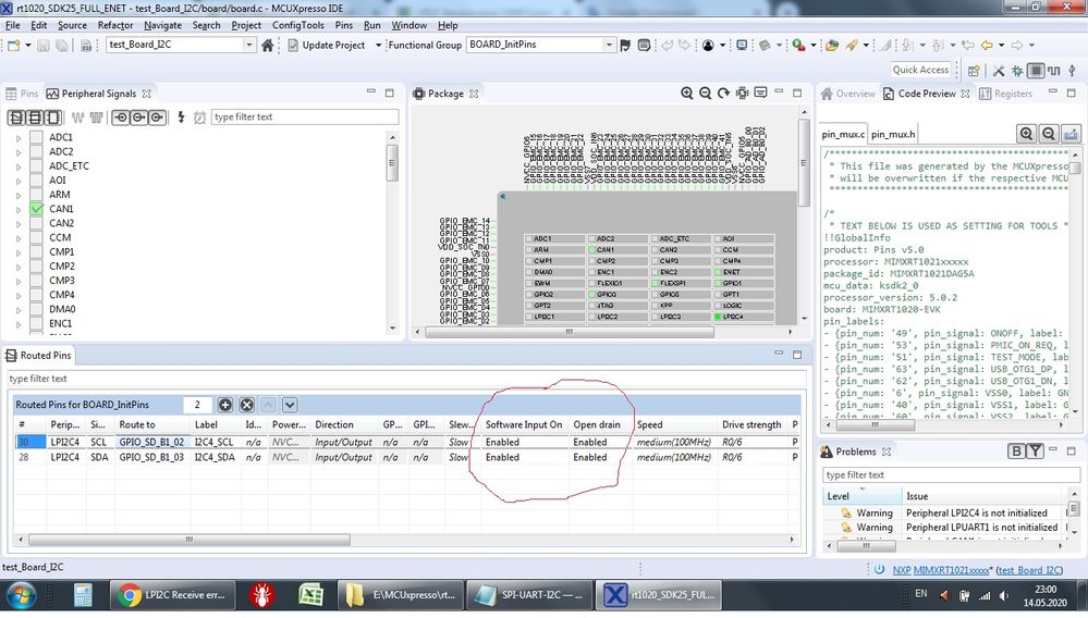

I had the same problem with RT1020 and PCF8563, and I found a solution:
- in MCuxpresso config Tool -> Pins set "Software Input On" to "Enable" (just like "Open Drain" ) for SCL and SDA
after that, I2C works finely, I checked it with BOARD_LPI2C_Receive() and BOARD_LPI2C_Send() functions (SDK_I2C_BASED_COMPONENT_USED=1 in Preprocessor setting) , and with CMSIS-I2C-Driver
Try, hope this help!
8,179 次查看
vasudhevan
Contributor V
Hi Oleg Lavrukhin,
       Thank you for your response.
       Sorry for late reply.
    - Already enabled
But still same issue.
Thanks & Regards,
       Vasu
