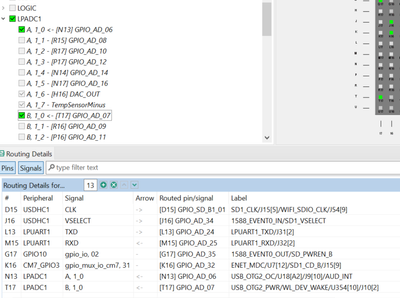

Dear support,
I'm designing a custom board based on IMXRT1176 and I have to configure LPADC1 to take a differential reading through  pins GPIO_AD_06 (A,1_0) and GPIO_AD_07 (B, 1_0). I'm using the MCUXpresso Config Tool under the peripheral section to add a new command. The tool allow me to select Channel sample mode=Differential mode (A as plus, B as minus) and Channel number=A, 1_0 » [N13] GPIO_AD_06 and B, 1_0 » [T17] GPIO_AD_07. The problem is that I have a warning that say Signal channel 1B is not routed. On the Pin section of the tool the LPADC1 is already selected for the pins GPIO_AD_06 and GPIO_AD_07.
Why I have this warning? Am I doing something wrong? Herewith enclosed a screenshot of the tool.
Thank you in advance for the support.
Kind regards,
Max83

Hi @Max83 ,
I tested both on MCUXpresso IDE and config tool. But I didn't see the warning. What's your tool version. I found the item name in Cahhenl number menu is different.
Have you set ADC pins in pin config window like this?
Jing

Dear Jing,
thank you for your reply.
I'm using MCUXpresso Config Tools Pins version 13 and Peripheral Version 12.0. The SDK in in version 2.13.1.
Yesterday I did some tests with the MCUXpresso IDE and I can confirm that the Channel number conformed with your one. But also in this tool I have the same problem.
I have discovered that the warning appears as soon as in the Peripheral Signals of the Pins tool I enable OTG1_ID on pin GPIO_AD_09. The funny thing is that when I rout  pin OTG1_ID on pin GPIO_AD_09, the LPADC1 peripheral generate the warning for every conversion command that involve the B part of the ADC. (e.g. Channel sample mode = Single end mode, using B and Channel number=B, 1_0 » [T17] USB_OTG2_PWR/WL_DEV_WAKE/U354[10]/J10[2] or B, 1_2 » [P16] USB_OTG1_OC/U26[A2]/J26[4] or B, 1_3 » [L12] SPDIF_SR_CLK/ANATOP_32K_OUT/J26[8] etc....
I'm starting to think there is a bug in this part of the tool. The generated code per the pin mux looks correct to me (see below).
What's your opinion?
Kind regards,
Massimo

Hi @Max83 ,
Yes, it seems like a bug. I'll report it. You can ignore the warning message.
