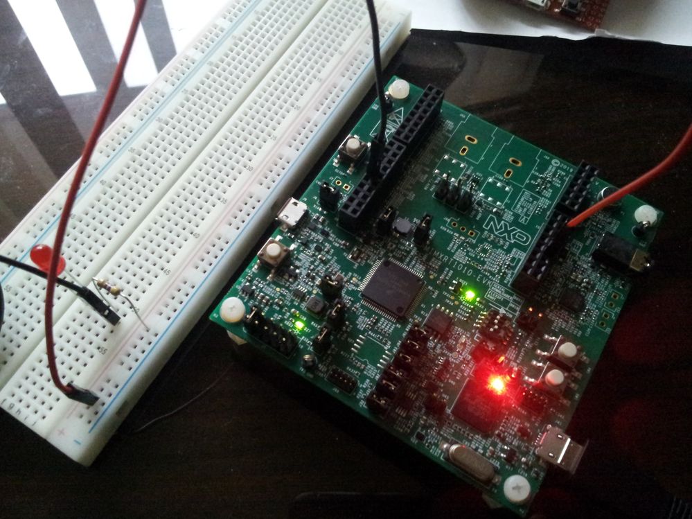

I would like to interface an LED to one of the Arduino interface pins on the i.MX RT1010 EVK and blink the LED, i.e. use the Arduino interface pin as GPIO.
So I just need to change the following definitions:
#define EXAMPLE_LED_GPIO BOARD_USER_LED_GPIO
#define EXAMPLE_LED_GPIO_PIN BOARD_USER_LED_GPIO_PIN
and connect the LED to the corresponding Arduino interface pin on the i.MX RT1010 EVK
Can you please give me an example of what to change "BOARD USER_LED_GPIO" and "BOARD_USER_LED_GPIO_PIN" to?
Also, which Arduino interface pin should I connect the LED to on the i.MX RT1010 EVK?
Also, can you please direct me to the document(s) with this information?

1) Can you please give me an example of what to change "BOARD USER_LED_GPIO" and "BOARD_USER_LED_GPIO_PIN" to?
-- For instance, I configure the GPIO_AD_04 as the pin to connect the LED
In the board.h
/*! @brief The USER_LED used for board */
#define LOGIC_LED_ON (0U)
#define LOGIC_LED_OFF (1U)
#ifndef BOARD_USER_LED_GPIO
#define BOARD_USER_LED_GPIO GPIO1
#endif
#ifndef BOARD_USER_LED_GPIO_PIN
#define BOARD_USER_LED_GPIO_PIN (18U)
#endif

1) Which Arduino interface pin should I connect the LED to on the i.MX RT1010 EVK?
-- Any pins which are able to be configured as the GPIO.

Thanks Jeremy, the main problem I'm having now is understanding pin multiplexing and GPIO configuration. Once I get my head around this I should be able to start uploading to the "Documents" section of the forum instructions on interfacing to displays and keypads and other projects. I hope that they will prove a helpful resource for beginners and free up NXP staff to focus on more complex questions.
I tried the suggestions you made above but was not able to get it working. Just to clarify, I'm trying to get the red LED on the breadboard in the photo below to blink: 20120311_160849.jpg
In your code you configured GPIO_AD_04.
In pin_mux.c in the SDK KPP example GPIO_AD_04 is column 2 of the matrix keypad, and in readme.txt is says column 2 is set to Arduino interface J57-10, so I thought to connect the cathode of the LED to J57-10 (black cable) and blink it using negative logic. I checked the hardware and everything seems fine - the red LED is not broken and the red cable is supplying 3.3V to the anode of the LED.
I made some modifications to the code and tried again, but at this point I was just guessing. Below is the final (unsuccessful) code I tried. It's the iled_blink example from the SDK with the following changes (I left the green led on the i.MX RT1010 EVK as a heartbeat - it's blinking as expected):
The board.h code (I only made changes in the /*! @brief The USER_LED used for board */ section - I commented out the original code and added my new code):

15,169 次查看
danielmilutinov
O.K. it's working now. The cathode of the red LED was connected to the wrong Arduino interface pin. It should be J57-8, not J57-10. There was a comment indicating this in pin_mux.h after I used Config Tools (a very useful tool!) to configure the GPIO. There is a nice example of how to use Config Tools in the "MCUXpresso IDE User Guide".
I'll create a pdf document with step by step instructions and upload it to the "Documents" section of the forum (provided non-NXP staff have permission to upload documents).
Thanks again for your help.

15,169 次查看
gerardo_arriaga
I used the code that you posted and followed your procedure and I was able to make it work.
Now I can move on to the next steps of the application that I want to implement. Thanks!
