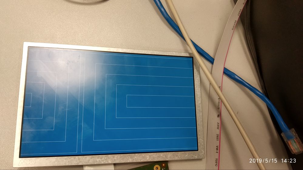

I am using my own design with IMXRT1062. I have connected S70KS1281 hyperram chip to FLEXSPI2 interface. All initialization of hyperram is based on AN12239SW example project.
Hyperram is working, I am able to do read/write test on address range 0x70000000 - 0x71000000 without any errors.  But I have problem with LCD frame buffer located in hyperram address range. If I am displaying static picture on the display, it is working well. But if I draw some points and lines to frame area, Image on the display is shifted to the side. I tried to change frame buffer location from hyperram to OC ram, and inside OC ram, the same source code is working well.
I think this is somehow related to switching between read and write operations on flexspi. I am doing a write operations inside main loop. And LCD driver is doing DMA read operations on backgroud.
My function for drawing pixels in main loop is looking like this:
#define LCD_FRAME 0x70800000
void Point(uint16_t color, uint16_t x, uint16_t y)
 uint32_t addr = LCD_FRAME + (2 * x) + (y * 800 * 2);
 *(uint16_t*)addr = color;
And I have this result on display:

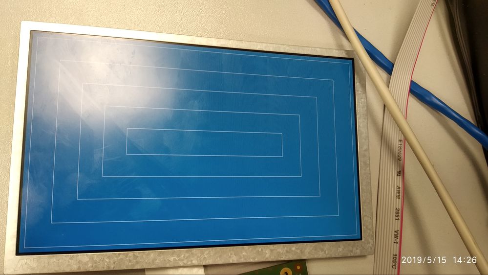

Then I modified draw function like this:
 while (!FLEXSPI_GetBusIdleStatus(FLEXSPI2))
And it solved the problem:
But I think this is not good solution. I think DMA controller should take care about this conflicts automatically...

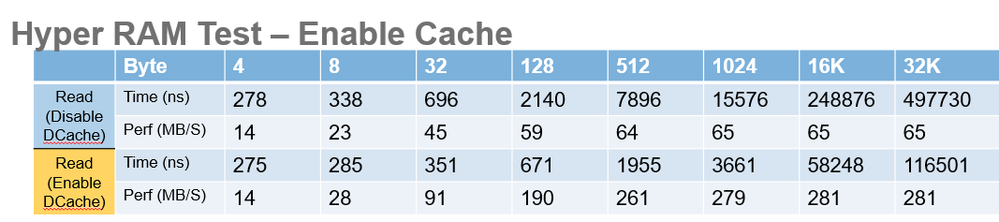

From our internal HyperRAM test performance, we with below recommendation:
  • Enabling cache to improve Hyper RAM performance more.

Hui_Ma
Hi Peter,
From our internal test result, the HyperRAM performance versus SDRAM, which SDRAM read throughput rate (ARM core read) is slower than HyperRAM:
HyperRAM MPU config:
    non-shareable
    Cacheable
    Write back
    Enable Dcache
best regards,
Mike
