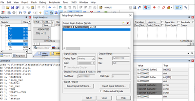

GPIO configurations in Logic Analyzer in keil v5.34 for imxrt1024.
I want to know the pin values on Logic anaylzer in KEIL MDK v5.34

I'm not familiar with Keil's Logic Analyzer. However, based on the information that I found, it seems that the purpose of this tool is to show a graphical analysis of value changes of variables or VTREGs. So, I think that what you are trying to do won't be possible with this tool. Unless you change a variable each time the value of the GPIO changes, this way you can observe the variable on the Logic Analyzer tool.

yes you said correct, GPIO pins assigned to variables is observed but any other option to assign direct PINS in logic analyzer,
I shown a example for another controller (LPC series)
Above Image shown for CortexM3 controller in keil (Logic Anlayzer)
But i want to know the syntax for GPIO's assign in Logic Analyzer for imxrt1024 controller

Thanks for the additional information. For this request, you'll need to contact Keil's support directly. This way, they will clarify whether this feature is supported for the RT1024 or not.
