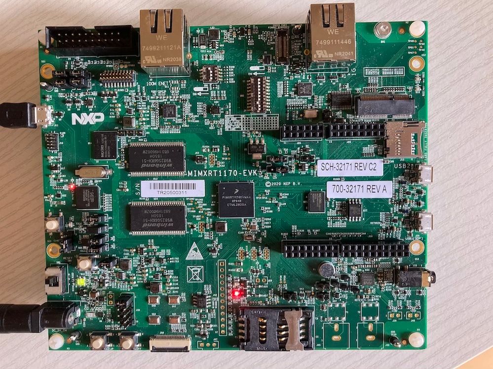

Dear all,
I modified the RT1170 eval board hardware according to chapter 2.6 in the EVK Board Hardware User's Guide, but now flashing a new firmware to the board (I tried with a simple blinky app) fails and the board does not work anymore.
In addition to modifying the hardware I turned switch SW1-3 and SW2-3 ON according to the EVK board user guide Table 3 (all other jumpers/switches left at factory default) and modified evkmimxrt1170_flexspi_nor_config.c in the SDK as suggested by @kerryzhou in this forum thread
I tried flashing via JTAG using Segger J-Link versions V6.98a and V7.20b, via GDB server on macOS. This worked fine with the QuadSPI flash. Now I do get some errors in the output and even after power-cycling the MCU the new blinky app seems to not run:

I also tried flashing with the onboard DAPLink programmer using J11 USB port but after dropping the bin file on the virtual usb drive a Fail.txt appears: "error: The interface firmware FAILED to initialize the target MCU type: target". Again, after resetting the MCU the app is not run.

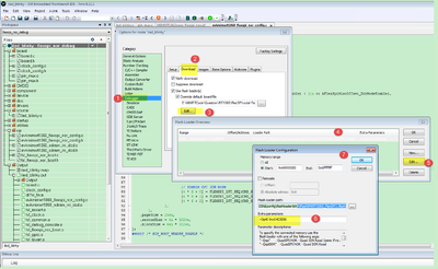

  Now, let's go it two ways, as I just checked at first, find your issues is mainly from the debug with IDE, and this method we need to get the correct flashloader at first. This is a little difficult, not like the RT1050 switch to the hyperflash, as different IDE, different debugger also use the different flashloader files.
MCUXPresso IDE, CMSIS DAP debugger, need to use the .cfx files, I check the MCUXPressso IDE install path, just MIMXRT1170_SFDP_QSPI.cfx, this is for QSPI flash, not the octal flash, about the octal flash loader .cfx, I still need to check it internally.
MCUXPresso IDE, JLINK debugger, need to use the JLINK driver, to the RT1020, RT1050, RT1060, need to use the JLinkDevices.xml, it will call the .elf file,  but to the new RT1170, it needs to use the JLINK related .dll, I think the default one is the QSPI, the octal flash related firmware still be lacked, you can check it with Segger side.

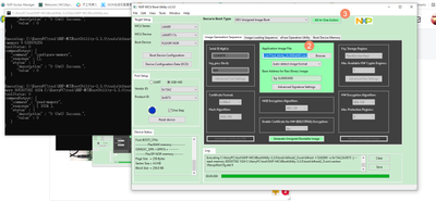

Another way, do you mind testing it without debug, I mean use the MCUBootUtility tool, this is very good and easy to use, as I find this tool totally can support the octal flash.
https://github.com/JayHeng/NXP-MCUBootUtility/archive/refs/tags/v3.3.0.zip
the related user manual is:
You even also can use the Tool attached RT1170 led_blinky code to test it.
Configuration like this:
Code use this one:
NXP-MCUBootUtility-3.3.0\apps\NXP_MIMXRT1170-EVK_Rev.A\cm7\led_blinky_0x60002000.srec
Download it, whether you connect and download works or not?
Please help to check it at first, without IDE and the Debugger.

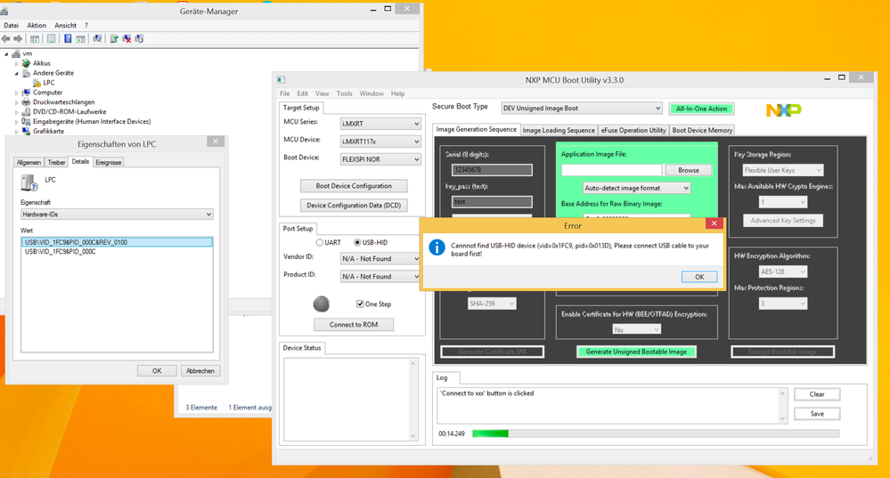

Regarding the MCUBootUtility: I sadly was not able to make this work either, the tool does not even find the board when I plug it in to Usb. It looks like it searches for a usb-device with vendor-id vid=0x1fc9, product-id 0x0135 but my board has vid=0x1fc9, pid=0x000c according to device manager. Do I need to change any of the jumpers on the eval board in order to make this work? Or is there a setting in the MCUBootUtility where I can override the usb product-id? I could not find this in the manual and am a bit lost at the moment, hopefully you can help here as well!

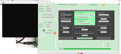

  Ok, now just talk the MCUBootUtility tool, do you use my previous picture configuration, and the tool attached image?
  If already do it like that, still can't work, please give me log, and the failed situation picture. I will help you to analyze it.

I configured the tool exactly as you described in your previous post. In step (5) ("Connect to ROM") the tool fails to connect to the board, even though I have it connected via USB, it is powered on, and I configured switches SW-1 to Serial downloader mode. As you can see in the screenshot Windows detects the usb device but with vendor-ID 0x1fc9 and product-ID 0x000c but MCUBootUtility looks for product-ID 0x013d and hence fails. Note that I also fitted jumper J22 on the eval board (this is not the default when I bought it), without J22 I get vendor-ID 0xd28, product-ID 0x204 and MCUBootUtility fails in same step with same error message.

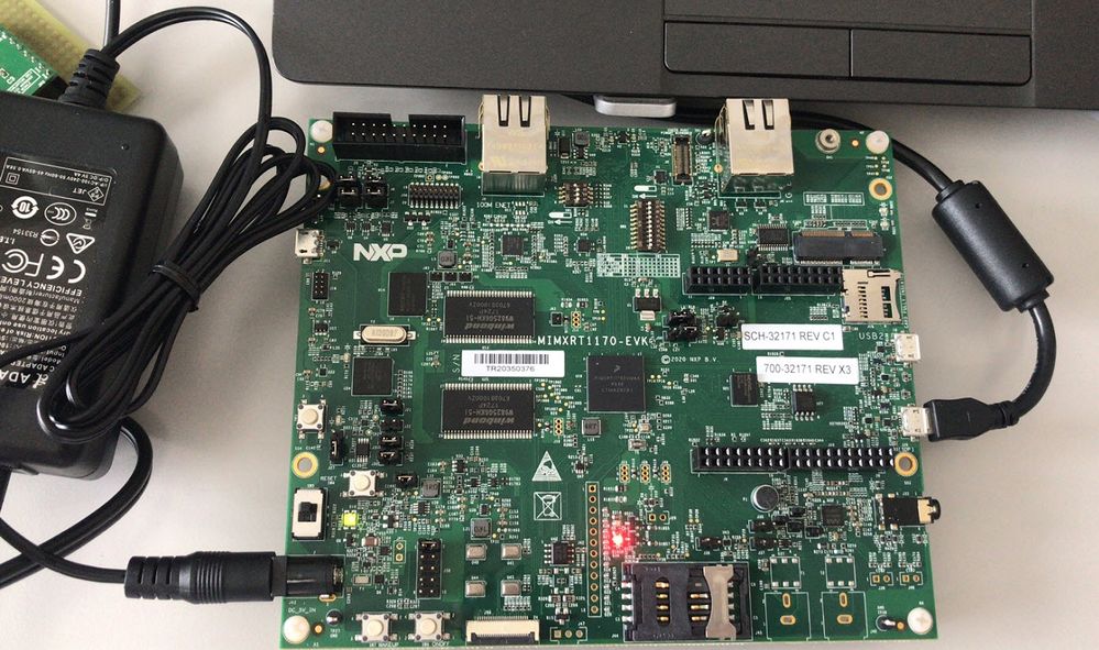

Your connection has issues, power is OK. USB port, please disconnect your USB cable from J11 to the right side, J20 USB1, then you will can find the  USB-HID:
Now, finish the downloading, reset device, change SW1 back to 0010,, SW2_3 ON.

Oh no what a stupid mistake! Thank you for being so patient, it's working now! I was able to connect to the board and flash the led_blinky_0x3000a000.srec, and the LED does blink! Great!

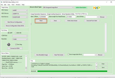

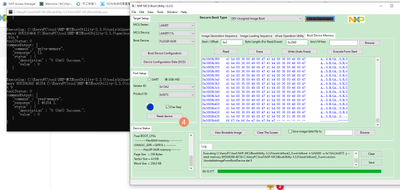

Use the tool to read out the memory, and give me screenshot:
Just check, whether the image is downloaded or not?
