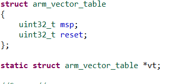

I am facing issue while jumping to application code.
I am using below logic:
But after executing above mentioned code, My code is going to some unknown state.
I need to know if I am doing something wrong?

According to your statement, it seems like you're testing the SBL with the RT1064, I was wondering if you can illustrate the steps you did, and further, share the UART terminal log.

Thanks for the reply.
Steps:
1. Created a bootloader code (SBL) with section size definition of 512KB
2. Created a Application code with section size as 3584KB
3. Merged both the binaries using J-link and Flashed in board.
4. Checking for jump - after flashing.
5. Board is going to unknown state.
Above mentioned steps, I followed and checked jump functionality but it's not working.
Hope above mentioned info will help you to understand the procedure.
Kindly help/correct me if I am doing wrong.

Thanks for your reply.
I guess the issue is related to the above steps, please refer to the attachment to create a good SBL project
