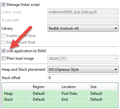

3) After enabling Link application to RAM, the demo will run in the RAM after entering debug mode, then check the error will happen or not.
Please give a try.

Thanks for the suggestion , We tried dumping the code using RAM option ticked in and we are about to flash the chip
We tried GPIO, PWM,UART examples
How every Flex SPI was taking us to semi hard fault handler
WE are not able to flash it into External flash , as running in RAM is not what we are looking for

We tried running the flexspi_nor_polling_transfer demo  in RAM as well , but it is ending in Semi hard fault Error handler .
Where as GPIO , UART and PWM are running fine when executed from RAM .
