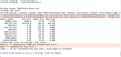

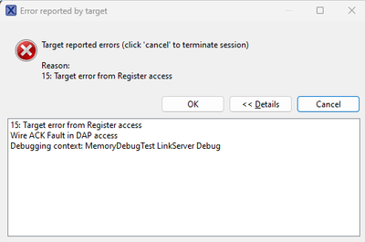

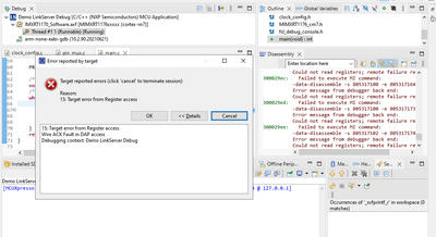

In MCUXPressoIDE while debugging my project, I am getting the following errors as shared in the below images. Please let me know what are configuration settings I am missing here. It was working correct when I am running the hello world program but while I run my project it giving me the errors.
I have shared the images of the errors I am encountering in both XIP mode and SDP mode. please check.

I have checked and observed that in my iMXRT1170-EVK, I am able to debug all the SDK example projects and getting the output as expected. But when I tried to run my project which I have created using MCUXpresso with all my pins and configuration I am getting this error.

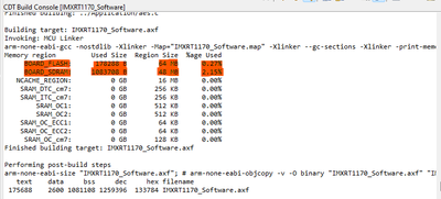

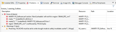

In this console shown SRAM_DTC_cm7 is used to 401.83%.(SRAM_DTC_cm7  overflowed).

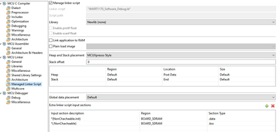

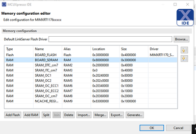

To resolve this issue we have changed the memory settings to BOARD_SDRAM as below.
Also,
After making these changes I am to build my code with zero errors. And tried to debug my code but encountered with the below error.
This error is the topic of my ticket to be resolve for which I have attached the images of the errors before also. Please let me know what am I missing when I created my project? Do I need to configure anything with respect to the memory configuration? How to solve this issue?

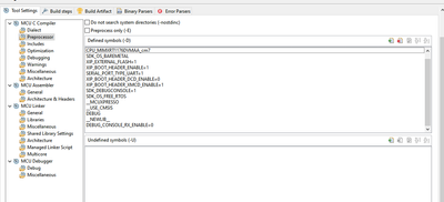

This is my preprocessor settings.

- Do you see these error before or after flashing the MCU with your code? Perhaps the first time you program the MCU with your code there is not issue, but the consecutive times there is a problem?
               I am getting these errors before flashing my code. When I run my code I am getting these issue not with the SDK examples.
- Are you able to program the MCU with any SDK example code after it was programmed with your code?
               No, After I tried to debug my code I am not able to program any example code on the board. But by changing the mode from XIP to SDP and running helloworld program and changing the mode back to XIP I am able to run the SDK example code successfully on the board.
- Does your code send the MCU to a low power state?
               No. There are no any configuration I have done here for it specifically.
- Are you able to program the MCU with your code after following the recovery process I shared with your earlier?
               No. I am not able to run my code, but by changing the mode from XIP to SDP and running helloworld program and changing the mode back to XIP I am able to run the SDK example code successfully on the board.

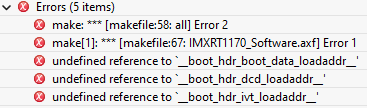

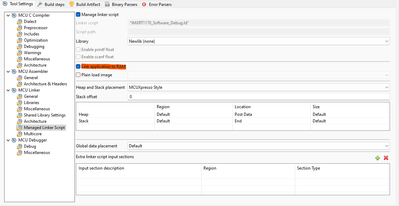

I have created a new project to run my code on XIP+SDRAM memory. But my code only uses SDRAM memory not the BOARD_FLASH as shown.
I have check here as I clicked to: link application to RAM so, it is using only SDRAM as attached.

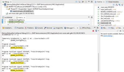

With this I am able to debug bot not able use the step-in and step-over options while debug. If I clicked on step-over/step-in it is stuck on the same line.
I want my code to be run with XIP+SDRAM as in previous case it is only using SDRAM memory. So I have untick the option of : Link application to RAM as shown.
After building with this setting my code is utilizes both XIP and SDRAM as expected.
But when I tried to debug this code, I am again getting this error.
Please let me know where am I missing any configuration, how to configure this memory to work it properly? your inputs will be appreciated.

8,014件の閲覧回数
Naveed
Hi Edwin,

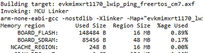

I found this SDK example evkmimxrt1170_lwip_ping_freertos_cm7 which uses the memory of BOARD_FLASH+SDRAM. After build,
And I am able to debug this on EVK, will be getting some output.
But when I try to merge the example code code of with lwip_dhcp_usb_freertos driver files and build it I am able to build it successfully by configuring the lwipopts.h file.
The build memory use is as below,
here NCACHE_REGION is also used. SDRAM is not utilized.
When debug this, I encountered with the same error again here,
It is not working this way, Can you tell me how to debug this issue? what causes this error?

Naveed
Hi Edwin,
Thanks for your reply.
I have followed the steps given in the shared link. I am getting this errors after adding the script to .ld file and building the code.
Error:
Please let me know how to resolve these errors.
Thanks in advance.
