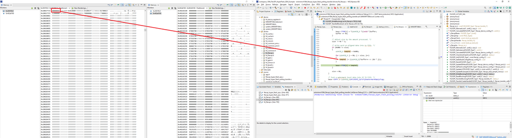

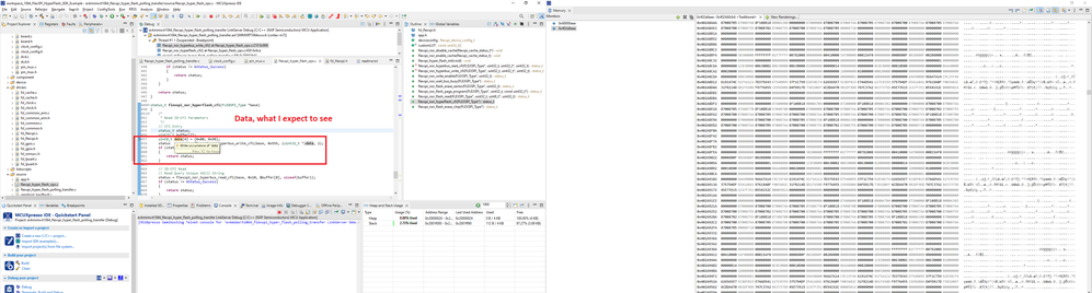

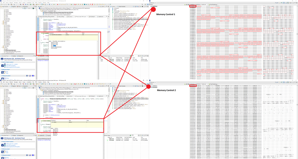

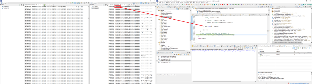

How can I test the memory region whether the data is written or not. Could you please check my below case? I am writing data at specific address with EVK. But I can't see the data which I write at memory address.
I am curious about the what is the correct address on my HyperFlash to check written data.
Figure 1: (Controlled Memory Addresses)
Figure 2: (The data buffer content which I expect to see.)
Edit:
I want to add some specific debug steps. I realized that:
It is also not writing to TFDR(transmit fifo data register) as well as not writing to the memory 0x60000AAA (addr*2 - 0x555*2).
I am on the EVK and trying to write HyperFlash but I can't understand why this case is happening?
Thanks and Regards.
