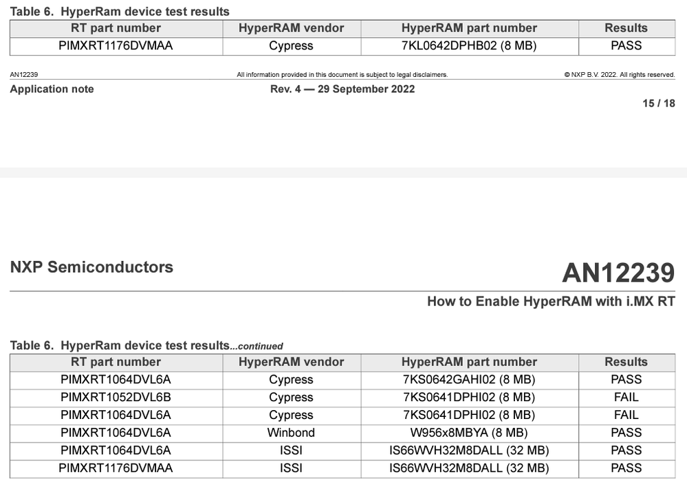

One things that makes me suspicious is below image.
According to above image which is a part of AN12239 doc, some of the Hyperrams are failed. Why? Is there possible to same issue happened for 6KS512SDABHV030. Or is there something that I miss during configuration?
What is the problem related with? Could you please help me?

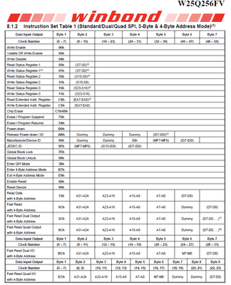

The LUT should be designed according to the specific commands from the memory datasheet. Here are some examples were customers modified the LUT table to work with the custom device.
Read Id using flex SPI on QPI mode - NXP Community
How to Enable Debugging for FLEXSPI NOR Flash (nxp.com) Chapter 5.4.1.1

Some HyperRAM devices, such as 7KS0641DPHI02, seem to have an issue in the test. The failed devices enter a hard fault when enabling read prefetch of FlexSPI. When there is a prefetch abort in the middle of command/address cycle, these failed devices seem to have an issue. To avoid the issue, prevent the prefetch abort during command/address cycle. The prevention is hard to implement for FlexSPI. Therefore, it is not recommended to use these failed HyperRAM on i.MX RT series.

Thank you so much for your help. Could you please correct me if I have any miss understanding?
I can use HyperRAM in my custom board by configuring LUT according the memory datasheet? Also, it is enough to use "evkmimxrt1064_flexspi_hyper_flash_polling_transfer" sdk example as base for HyperRAM. I only will configure LUT and things going on.
I also examine the first link you shared. The memory which is used by that people have some specific commands to configure LUT commands. It has a instruction set table like below, but I am using S27KS0641DPBHV020 and it has not a Instruction Set Table. I am curios about whether the LUT Instruction like Read Status (0x05), Write Enable (0x05), Erase Sector (0x20) and etc. are universal codes or not ? I get this values from default SDK example of evkmimxrt1064_flexspi_hyper_flash_polling_transfer.
Thanks and Regards.
3,372 Views
Omar_Anguiano
LUT instruction may vary depending on the memory. I cannot assure you that instructions like Read Status (0x05), Write Enable (0x05), and Erase Sector (0x20) will be available on all memories under the same index.
