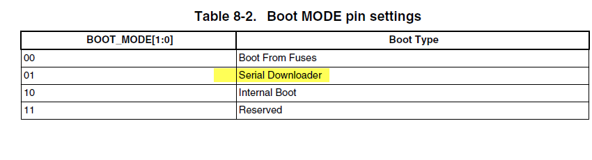

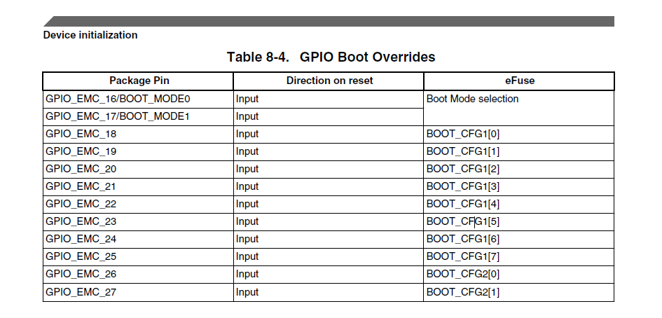

  Please use the JLINK commander to check your customer board with the SWD interface, whether you can find the ARM core or not?
  If you can find the ARM core, please configure the BOOT_CFG[1]-BOOT_CFG[6] to 0, BOOT_CFG2[0]-[1] to 0, BOOT mode configure to the serial download mode, you can find the related BOOT-CFG and BOOT_MODE pins in this table:
then use the MCUBootUtility to connect your board and download the code to the QSPI flash.
Please try it at first.
If you still have questions about it, please kindly let us know.
Kerry
