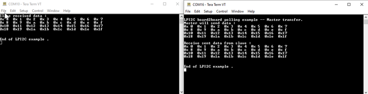

5,124 Views
DanielRuvalcaba
Hi @nsi,
I'm sorry for the late response.
I tried the lpi2c_polling_b2b example with the -0s optimization, and seems to be working on my side. I didn't find any problem with the transfer.
This makes me think that the problem might be related to your application. I'd recommend you to check your code and try to see if there is any wrong use of variables, registers or any other thing that can cause a bad optimization.
Daniel.
