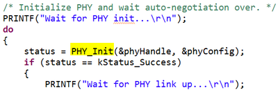

2,670件の閲覧回数
RaRo
Hello @JarvisC,
Just for double check, could you please check if you initialize the PHY before the PHY_Read and PHY_Write? Look how the example initializes PHY.
[evkmimrxrt1060_enet_txrx_transfer -> source -> enet_txrx_transfer.c -> main()]
Also, please verify if the Auto-Negotiation is disable before setting the Power Down bit, and the proper MODE[2:0]: Mode Configuration. For more information regarding the LAN8720 Basic Control Register please look at the datasheet.
[LAN8720A/LAN8720Ai Datasheet. Section 4.2.1 Basic Control Register]
Best regards, Raul.
2,661件の閲覧回数

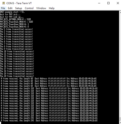

JarvisC
Dear Raul,
I had set "phyConfig.autoNeg = false" to try to read/write PowerDown bit, but it is still not working.
PHY_BCTL_AUTONEG_MASK-R : 3100
PHY_BCTL_PowerDown_MASK-R : 3100
PHY_BCTL_PowerDown_MASK-W: 1
PHY_BCTL_PowerDown_MASK-R: 0
#ifdef EXAMPLE_PHY_INTERFACE_RGMII
config.miiMode = kENET_RgmiiMode;
#else
config.miiMode = kENET_RmiiMode;
#endif
phyConfig.phyAddr = EXAMPLE_PHY_ADDRESS;
phyConfig.autoNeg = false; //true
mdioHandle.resource.base = EXAMPLE_ENET;
mdioHandle.resource.csrClock_Hz = EXAMPLE_CLOCK_FREQ;
/* Initialize PHY and wait auto-negotiation over. */
PRINTF("Wait for PHY init...\r\n");
do
status = PHY_Init(&phyHandle, &phyConfig);
if (status == kStatus_Success)
PRINTF("Wait for PHY link up...\r\n");
/* Wait for auto-negotiation success and link up */
count = PHY_AUTONEGO_TIMEOUT_COUNT;
do
PHY_GetAutoNegotiationStatus(&phyHandle, &autonego);
PHY_GetLinkStatus(&phyHandle, &link);
if (autonego && link)
break;
} while (--count);
if (!autonego)
PRINTF("PHY Auto-negotiation failed. Please check the cable connection and link partner setting.\r\n");
} while (!(link && autonego));
PHY_Read(&phyHandle, PHY_BCTL_AUTONEG_MASK, &data);
PRINTF("PHY_BCTL_AUTONEG_MASK-R : %x\r\n" ,data);
result = PHY_Read(&phyHandle, PHY_BCTL_PowerDown_MASK, &data);
PRINTF("PHY_BCTL_PowerDown_MASK-R : %x\r\n" ,data);
PHY_Write(&phyHandle, PHY_BCTL_PowerDown_MASK, data1);
PRINTF("PHY_BCTL_PowerDown_MASK-W: %x\r\n" ,data1);
PRINTF("PHY_BCTL_PowerDown_MASK-R: %x\r\n" ,data);

RaRo
Hello @JarvisC,
Could you please try with the following changes?
  • First, at main [source -> enet_txrx_transfer.c] leave the code as it was. Only change the autoNeg to false:
 phyConfig.ops      = EXAMPLE_PHY_OPS;
 phyConfig.resource = EXAMPLE_PHY_RESOURCE;
 do
  • Then change from:
 #define PHY_BCTL_PowerDown_MASK 0x0800U
 PHY_Read(&phyHandle, PHY_BCTL_PowerDown_MASK, &regValue);
 PHY_Write(&phyHandle, PHY_BCTL_PowerDown_MASK, 0x1);
          To:
 #define PHY_BSTATUS (0x00U)
 #define PHY_BTCL_PowerDown_MASK ((uint16_t)0x0800U)
 PHY_Read(&phyHandle, PHY_BSTATUS, &regValue);
 PHY_Write(&phyHandle, PHY_BSTATUS, regValue | PHY_BCTL_PowerDown_MASK);
Hope these modifications helps you.
Best regards, Raul.
2,634件の閲覧回数
JarvisC
Dear Raul,
After modify the source code , the register value will change from 0x3100 to 0x3900 that bit 11 had been set to 1.
Thanks.
