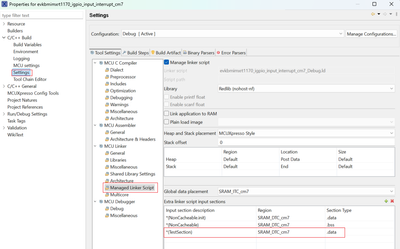

Hi @simmania ,
I suggest you can refer this link wrote by a NXP expert.
https://www.nxpic.org.cn/module/forum/thread-623079-1-1.html
I use a MIMXRT1170-EVKB board for example, MCUXpresso IDE v24.9.25 version to do this validation.
It is same if you use MIMXRT1010 board, Please refer to what I have done.
I import a SDK demo "evkbmimxrt1170_igpio_input_interrupt_cm7"
In the next MCUXpresso IDE project config , the SRAM_DTC_cm7 space is specified for storing the readwrite segment.

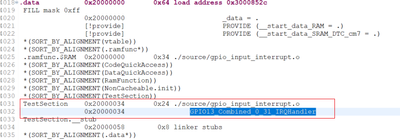

Method 1:    use __RAMFUNC()
In my project, I put function "EXAMPLE_GPIO_IRQHandler" to Ram.
the .map file describe the address of function EXAMPLE_GPIO_IRQHandler is in Ram.
Method 2:  use Specify functions for custom sections
__attribute__((section("TestSection")))
This method is also working.
Wish it helps you.
