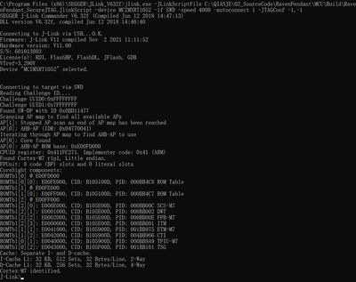

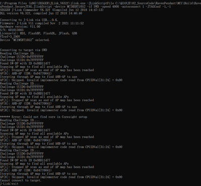

JerryQian_132
Hi Kerry,
Sure. The eFuse settings are 0x400 : 0x40128043 and 0x460 : 0x04400012.
My test script has attached. Below are my steps.
  • Step 1: reboot the device
  • Step 2: jlink.exe -JLinkScriptFile NXP_RT1052_SecureJTAG.JlinkScript -device MCIMXRT1052 -if SWD -speed 4000 -autoconnect 1 -JTAGConf -1,-1
    Cannot connect to the target
  • Step 3: jlink.exe -JLinkScriptFile NXP_RT1052_SecureJTAG.JlinkScript -device MCIMXRT1052 -if JTAG -speed 4000 -autoconnect 1 -JTAGConf -1,-1
    Cannot connect to the target. But can read the challenge ID
  • Step 4: jlink.exe -JLinkScriptFile NXP_RT1052_SecureJTAG.JlinkScript -device MCIMXRT1052 -if SWD -speed 4000 -autoconnect 1 -JTAGConf -1,-1
    Cannot read the challenge ID. But can connect to the target.
Is it possible that combine step 3 and 4 with one command? Change the script?

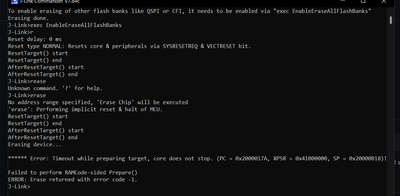

Dear Support Team,
I am getting error while erasing the IMX1052 board and following is the error:
Below are the logs:

J-Link>erase
No address range specified, 'Erase Chip' will be executed
'erase': Performing implicit reset & halt of MCU.
ResetTarget() start
ResetTarget() end
AfterResetTarget() start
AfterResetTarget() end
Erasing device...
J-Link: Flash download: Only internal flash banks will be erased.
To enable erasing of other flash banks like QSPI or CFI, it needs to be enabled via "exec EnableEraseAllFlashBanks"
Erasing done.
J-Link>exec EnableEraseAllFlashBanks
J-Link>r
Reset delay: 0 ms
Reset type NORMAL: Resets core & peripherals via SYSRESETREQ & VECTRESET bit.
ResetTarget() start
ResetTarget() end
J-Link>erase
ResetTarget() start
ResetTarget() end
Erasing device...
****** Error: Timeout while preparing target, core does not stop. (PC = 0x2000017A, XPSR = 0x41000000, SP = 0x20000B18)!
Failed to perform RAMCode-sided Prepare()
ERROR: Erase returned with error code -1.
J-Link>
Let me know if you need more information.
