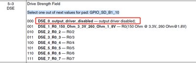

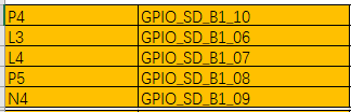

In the project, the following pins are used as SPI. After SPI communication is completed, they need to be configured as high impedance output. However, there is no relevant description in the register. How should we configure these pins to output Hi-Z?
ps:000 DSE_0_output_driver_disabled == Hi-Z ??

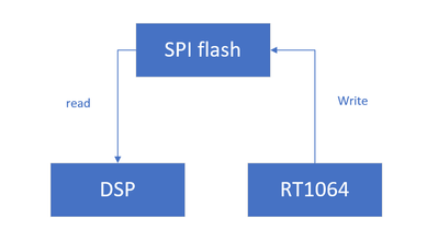

As shown in the figure below, RT1064 spi2 is used to import data into SPI flash, and DSP loads firmware from SPI flash, which means that MCU and DSP SPI are connected together;
To avoid the influence of MCU side during DSP startup, we want to set the SPI2 wires as Hi-Z

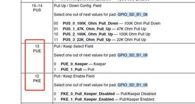

2, Disable the pull up and pull down
-------To make this effective, just PKE=0 is enough, or PKE=0, PUE=1?
17 次查看
Gavin_Jia
Hi @foreverwlh2025 ,
Just PKE=0 is enough.
