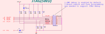

I have gone through the schematic of the MIMXRT1060-EVKB, where I found a JTAG (SWD) 20-pin connector labeled as J2. If I connect these pins directly to the MIMXRT1062DVJ6B processor, is it possible to flash the program directly using the Segger J-Link V2?
It is possible, but the JTAG connector is used as SWD as default, for changing the interface may need to do a rework on the EVK, if you want because the SWD works to flash too.

Is there any reference design available for the same? please provide.
attached.
