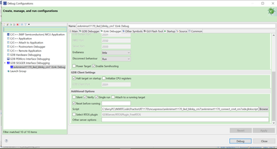

   Do you have tested the SDK code, use the JLINK to debug in the SDRAM, whether that is OK or not?
   SDK code already contains: evkmimxrt1170_connect_cm4_cm7side.jlinkscript
  In the JLINKscript, it configure the SDRAM at first, to the debug mode in SDRAM, it also need the script to initialize the SDRAM at first, please try it on your side.
  I use the SDK code and test it with JLINK, it works OK.
  So, you also can follow me to test the SDK led_blinky code with the JLINK debugger at first, then after it works, you can use your mqx porting code.
The JLINK script can be found from this link:
SDK_2_10_0_MIMXRT1170-EVK\boards\evkmimxrt1170\demo_apps\led_blinky\cm7\evkmimxrt1170_connect_cm4_cm7side.jlinkscript
Please try it on your side.

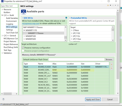

Before that, my query is how to debug from SDRAM, here from the pics that you have shared that has BOARD_FLASH as a default memory. It means it is debugging from Flash and not from SDRAM.
12,308件の閲覧回数
kerryzhou
Hi @venkataddagatla ,

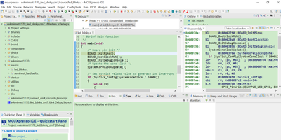

   my laster reply picture 3, select link application to RAM, that already set the code to the secondary one sdram. This is the special good function in the MCUXPresso IDE.
  You also can check the build image, the code is in the SDRAM, you even see my debug result, the code is in the sdram.
