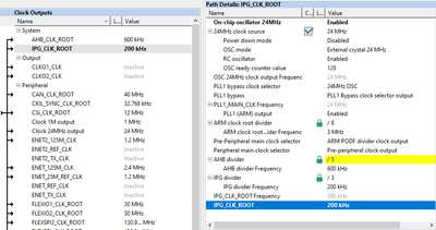

Hi Alan,
What you can do is reduce the IPG_CLK_ROOT to 200 kHz and using a prescale of 4, with that you can get the frequency of 1 Hz in your PWM.

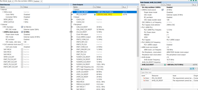

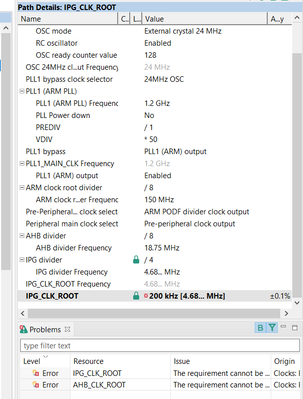

Sorry for the late reply. I tried based on your screen shot  but I faced some issue in clock settings.
can you pls help me on this.
When I try to make 600KHz AHB and 200KHZ IPG its showing some error.
