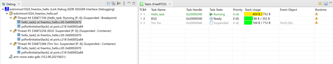

I'm debugging a FreeRTOS sample project on i.MX1024EVK using MCUXpresso version 11.7.1. Using JLink SWD, the 'Select RTOS plugin' is set to 'GDBServer/RTOSPlugin_FreeRTOS'. Optimization is set to none (-O0). When debugger is stopped, the 'Debug' view in MCUXpresso is populated with the correct number of tasks, but they all have the same backtrace. This seems like it would be a frequently reported issue, since I have a fairly default setup, using the EVK with a sample project, but I can't find a similar reported issue anywhere. The GDB command line in 'Debugger Console' reports the same results. This issue is observed with multiple sample and custom projects.
Any help appreciated.

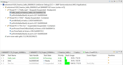

Hi @lemk34,
I'm not able to reproduce this issue. As you can see on the following screenshot, I am able to see the proper backtrace for each one of the tasks from the hello_world_freertos example:
It is worth noting that I am using an RT1020EVK with the onboard debugger, but this goes to show that there is no limitation about the backtraces not displaying properly. I am also using MCUXpresso IDE version 11.9.0. Please try with the newest version of the IDE, as bugfixes and improvements are constantly being applied to newer versions of our IDE.

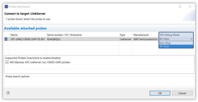

Hi @lemk34,
Quick question. Are you certain you are debugging on All-Stop mode (rather than the default Non-Stop mode)?
This is one of the steps needed to do thread-aware debugging for FreeRTOS applications, for example. I got this from the MCUXpresso IDE FreeRTOS Debug Guide, which if you haven't read, I highly recommend you do so. You can find this guide on your MCUXpresso IDE installation path, by default it should look like this: <C:\nxp\MCUXpressoIDE_11.9.0_2144>.
