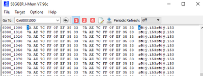

I have verified this on my end. When you boot in serial downloader mode, typically you can't read the contents of the flash memory. Since the ROM bootloader did not initialize the FlexSPI peripheral and it won't since the i.MX RT MCUs are designed to run with many external flash vendors, so it leverages FlexSPI initialization, according to the specific flash, to flashloader.
The below picture shows J-Mem reading garbage from i.MX RT1020 NOR flash at 0x6000_1000, where the IVT resides for a previously programmed XIP image. This reason is because the MCU booted in serial downloader mode and did not initialize FlexSPI.
However, you can read the flash when you originally booted in serial downloader if you load and run an application on RAM and that app enables the FlexSPI peripheral successfully.

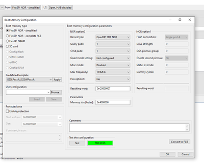

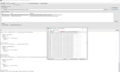

Write an image with the MCUXpresso Secure provisioning Tool and then read over SWD flash memory contents. See below picture.
Or if you already got an image, you can use test the flash configuration, which will initialize the FlexSPI.
Basically,  what the SPT did here is: tell the bootROM to load the i.MX  RT1020 flashloader, then send commads (over BLHOST) to the flashloader to initialize the FlexSPI peripheral.

Thank you Deigo.  I was also able to find a Kinetis bootloader image and host-PC blhost application to use with it.  With the sdphost, I was able to upload the bootloader image into the MCU RAM and use it to look around while the MCU is in Serial Download mode.
