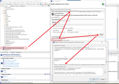

1. Regarding how to use JLink Commander, if you are not familiar with it, we recommend you to operate it once with MCUXpressoIDE and then read the script file it generates.

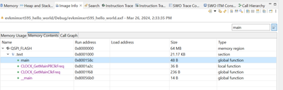

2. About how to see if you're in main:
You can look at the Image information through MCUXpressoIDE to get the run address of the main function, and then, in JLink Commander, put a breakpoint here.

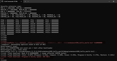

Yes, I understand your point. The reason for pointing out how the IDE operates is because it is possible to visualize here every command used by JLink Commander at the time of flash image. We can use them through JLink Commander. The picture I attached is how it works with JLink Commander.
For a detailed list of exactly how to set up commands such as the PC pointer, Segger provides this: https://wiki.segger.com/J-Link_Commander
