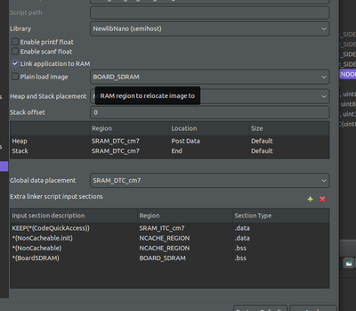

I tried to make XIP mode offline for testing. But I am having problems. I change the following values ​​from 1 to 0
XIP_BOOT_HEADER_DCD_ENABLE
XIP_BOOT_HEADER_ENABLE
After these changes, the treasures are as follows:
After this, i activated the "Link application to RAM" option:
I make these changes in the M4 project, compile and flash, but I cannot run the code. What could be the problem?

I use my custom project. In my project, M4 runs in RAM while M7 uses XIP. Before making the changes I mentioned above, after compiling the project, 1 percent of the flash was shown to be used, but after making the changes, Flash is not shown to be used.

SpeedyGonzalesss
I had to move the IVT block before copying it to RAM. This is how I was able to do it. Thank you
