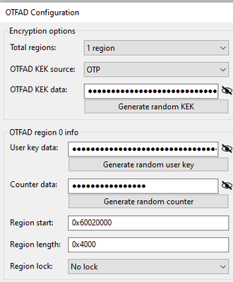

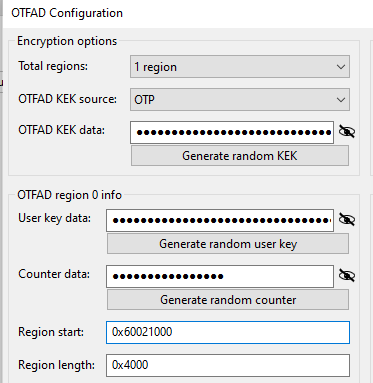

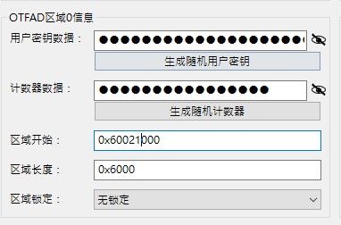

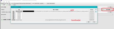

1.  The customer use MCUXpresso Secure Provisioning Tool v9 to enable OTFAD function.
2. Only encryption application code.
3. MIMX RT1010 -EVK can reproduce  this issue.
below is Secure Provisioning Tool v9 setting screenshot.
Fail
Pass

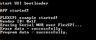

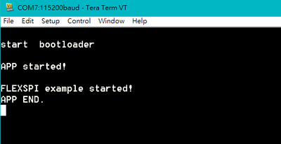

Just a question, how are you creating and loading the secondary application?
1.I first used a new RT1010 EVB (not burn any efuse )to create the following bin file.
2.use the NXP IDE to flash the bootloader into the RT1010, and then use the NXP-MCUBootUtility to flash the app bin file into the RT1010.
3.use NXP-MCUBootUtility to download Full_Plaintext.bin(bootloader + app)
With the SPT is easy to program the bootlaoder and the flexSPI application as an additional image. but I do not know the process you are following.
I tried this feature, but the app section didn't succeed in encrypting, and the test results were also unsuccessful.

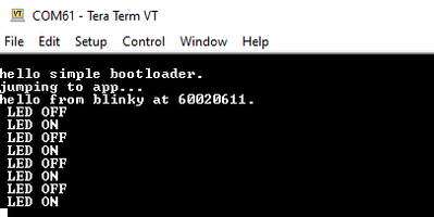

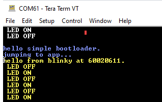

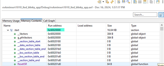

I created my own bootloader image  at 6000_2000  and led_blinky image at 0x6002_0000, then I merged together to create a single binary. Easiest way I found to create a single binary with both bootloader and application was write both applications and export the memory contents of the flash using Segger's J-MEM.  I created a single binary to use the SPT to encrypt the image with ease.
Below my test results.
1 If I set OTFAD Region 0 to 0x6002_1000 ( 4 KB offset from  entry of led_blinlky application), which is after the application entry, I can successfully boot the application.
Below application memory details.
Below evidence.

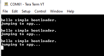

2 If I set OTFAD region 1 to 0x6002_0000, encrypting the vector table, main function and a bit of the first part of the application, I can NOT boot the application. .
You can see the resets I made, jump can not be achieved.
