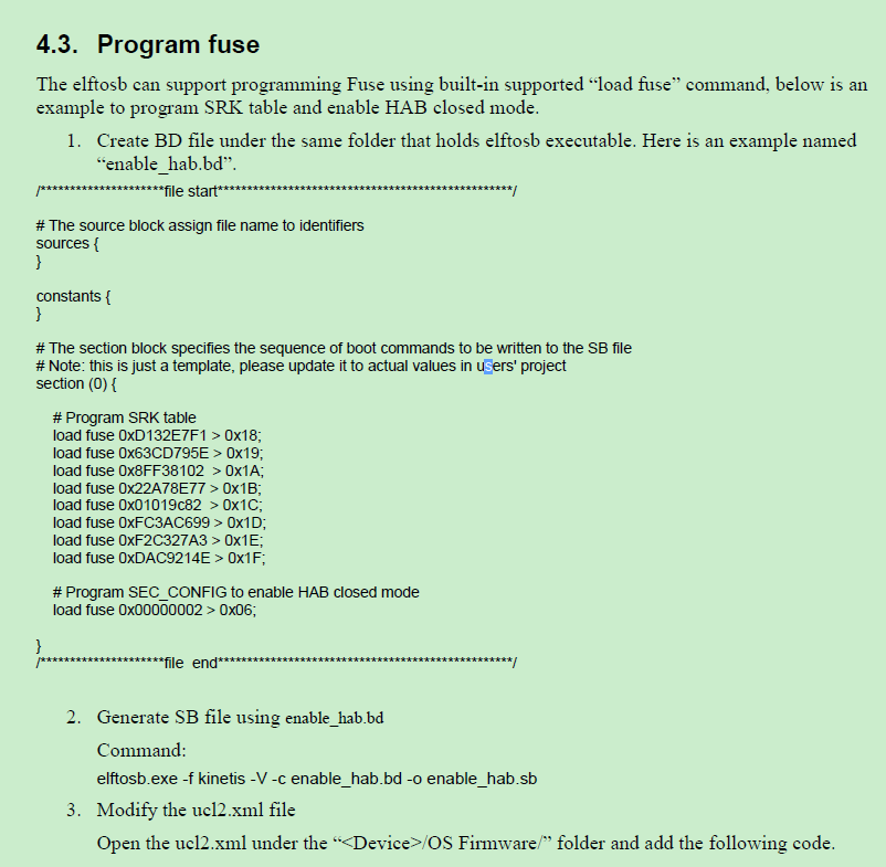

I have been able to use MCUboot Utility to burn the efuses and program the flash; thank you for helping with that!
Now our requirements changed, we need to do all the efuse burning and flash programming using Flashloader/MfgTools. Could you please recommend and user guide or document I could use to do the flash programming and efuse burning.
what are the registers addresses and names for efuses burning?

Hi Andre marcus ,
   Thanks a lot for your trust, you can refer to the application note AN12079:
https://www.nxp.com/webapp/sps/download/mod_download.jsp?colCode=AN12079&location=null&appType=moder...
  Chapter 4.3. Program fuse
Wish it helps you!
If you still have questions about it, please kindly let me know.
