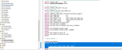

PLEAE TELL in this below example how the developed decided these phy address and mac address

jingpan
Hi @achal ,
What you marked in the screenshot is mac address. PHY address is defined in board.h
/*! @brief The ENET PHY address. */
#define BOARD_ENET0_PHY_ADDRESS (0x02U) /* Phy address of enet port 0. */

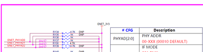

jingpan
Hi @achal ,
PHY address is determined by PHY address config pins on the PHY chip. Please refer to the EVK board.
MAC address is random in the demo. Officially it is allocated by IEEE (Institute of Electrical and Electronics Engineers), the last three bytes, the hexadecimal number AE-3C-40 represents the serial number of a certain network product (such as network card) manufactured by the manufacturer.
