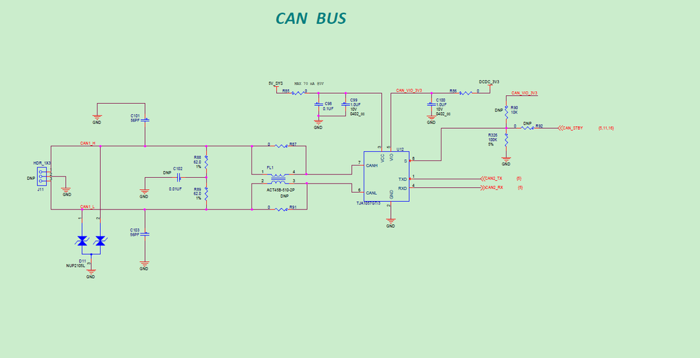

  About the CAN connection, you can refer to the RT1060-EVK board and the related code:

  In fact, from the SLN-Alexa-IOT schematic:
  https://www.nxp.com/webapp/Download?colCode=SLN-ALEXA-IOT-SCH&appType=license

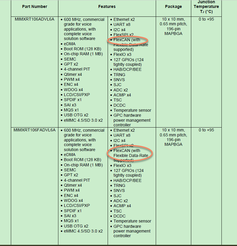

  You can find the RT106A didn't add the CAN transceiver chip, it means the SLN-ALEXA-IOT hardware can't support the CAN transceiver directly, you need to add external related CAN chip.
  But RT106A chip can support the flexCAN module.

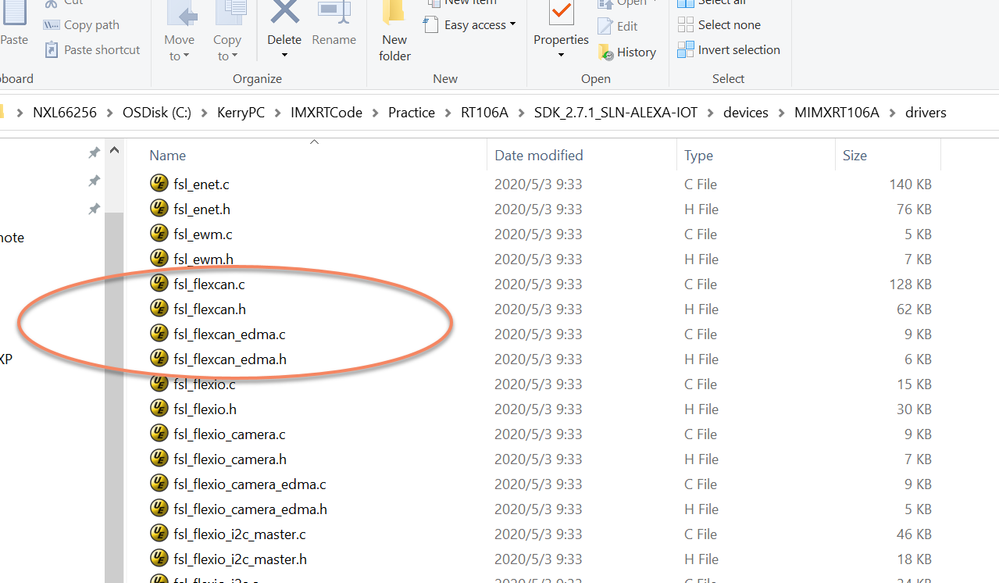

From the SLN-Alexa-IOT driver, it also has the flexcan driver:
  SDK_2.7.1_SLN-ALEXA-IOT\devices\MIMXRT106A\drivers
So, if you want to use it, you can use the can driver, about the examples, I think you can refer to the RT1060 SDK flexcan examples, the code can be downloaded from this link:

Thank you. I was able to find and load the flexCAN examples. However, how would I go about connecting a CAN transceiver chip in order to utilize the flexCAN drivers already provided? What transceiver chip do you suggest and which pins would be need to be connected to?

1, transceiver chip you can refer to my first reply, already give you the RT1060 CAN transceiver chip from the schematic, TJA1057GT
