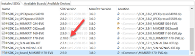

Hello everyone,
I  download the DeepViewRT SDK(RT1170+eIQ)  from this link (  https://www.nxp.com/design/software/development-software/eiq-ml-development-environment/eiq-inferenc...)  and I installed it by drag & drop the zip into "installed SDKs" , and I can run the model runner sample without problems
And I also download and install  the standard sdk (2 .9.1   / 2.9.2/ 2.10.0)  from https://mcuxpresso.nxp.com/en/welcome
When I run the sample project  modelrunner (for example 2.9.2) , I find that error happens like follows
If without the deepview SDK (SDK_2.x board_MIMXRT1170-EVK) , the sample project can build well.
if with the deepview SDK (SDK_2.x board_MIMXRT1170-EVK) ,the error will occur
 Although I can fix it by rename the defined eiq interrupt....
Do we need to call uesrs' attention to this problem?

Hi Zhou,
  The DeepViewRT library included with the SDK is specific to the eIQ Portal version. So they need to be kept in sync. There's not a way to fix that other than using the latest SDK and latest version of eIQ Portal. I'll have the web team take those links down on the website to avoid future confusion.
-Anthony

Thanks for your confirmation. I also check that The new standard SDK(2.10.0) works well with the deepview SDK (SDK_2.x board_MItellMXRT1170-EVK).
I will tell customers  to update SDK to the new SDK(2.10.0).

I try it just a moment ago, the issue won't raise when the SDK_2.x_MIMXRT1170-EVK is updated to 2.10.0.
