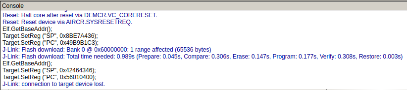

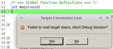

I am trying to get debugging working for my MIMXRT1021.
I am using the MIMXRT1020-EVK with a Segger JLINK. Downloading my image works fine and it is running as expected however when I try to debug using Segger Ozone I receive the following issues:
I know that debugging is working because my JLink etc. is working perfectly fine with MCUXpresso IDE.
However I would like to get it working with Ozone :-).
Am I missing some additional configuration I need to do in order to get it working? I tried to figure out if MCUXpresso IDE is setting something behind the scenes already but to no avail. Maybe someone else has tried with Ozone and ran into the same issues.

alphafred
@Kerry Zhou
Thank you for referencing me to the Segger support. Could have thought of that myself :-).
They could help me solving my issue.
For anyone running into the same problem I did, here is the solution. Since MIMXRT1020 is using a ROM bootloader this information has to be given to JLink. Each Ozone project is actually a .jlink file containing all the hooks etc. that you can use in order to control the debugger.
This page of the SEGGER wiki contains the answer to the problem - "the functions AfterTargetDownload() and AfterTargetReset() empty (but not commented out!)".
