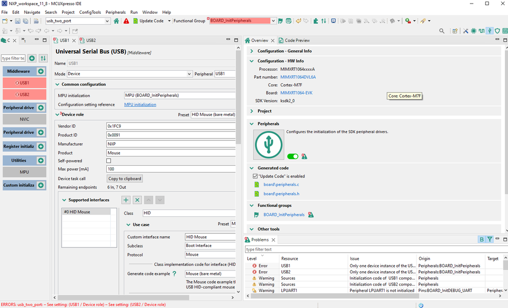

I am trying to configure USB1 and USB2 of RT1064 as USB device on RT1064 EVK. But not able to configure USB1 and USB2 as devices at the same time. The IDE and SDK version are "MCUXpresso IDE v11.8.0" and "SDK_2_14_0_EVK-MIMXRT1064". According to the datasheet, I think RT1064 can support USB1 and USB2 as device simultaneously. Is there any way to test two port of USB device, which have different VID/PIDs?

Hi @namsu_mun,
Please look into the following community article for more information about implementing dual USB on the RT1060 devices: https://community.nxp.com/t5/i-MX-RT-Knowledge-Base/Implementation-of-Dual-USB-Host-on-RT1060-EVK/ta...
Let me know if you have further inquiries about this issue!

Dear Edwin,
Thank you for the reply.
I think RT1064 has two USB OTGs, so can support two USB devices. Is there any restrictions or precautions for using two USB devices (USB1 and USB2)? If you have any references, please let me know.
