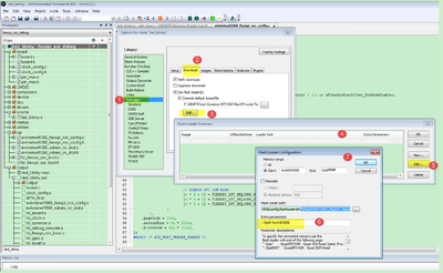

Do you use the IAR project or not? As I have the experience for RT1060 with the octal flash:
And the XIP header, you still use the previous code which I told you.
