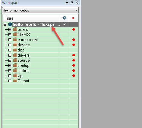

1) But does code go to SRAM?
-- In the SDK library, the demos project not only allows you to debug it in the RAM but also in the QSPI flash just like the below figure shows.
