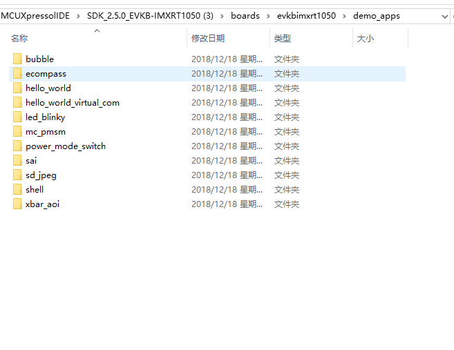

1914795885
Hi Jorge Alcala
Thank you very much, this is very helpful to me, but I did not find this source code in sdk_2.5.0_evkb-imxrt1050, can you send me the source code in a document?
main i
3,868 Views
jorge_a_vazquez
Hi main i
No, this example code is not included in the SDK software, but you can find it associated with the application note:
https://www.nxp.com/docs/en/application-note-software/AN12110SW.zip
Hope this helps
